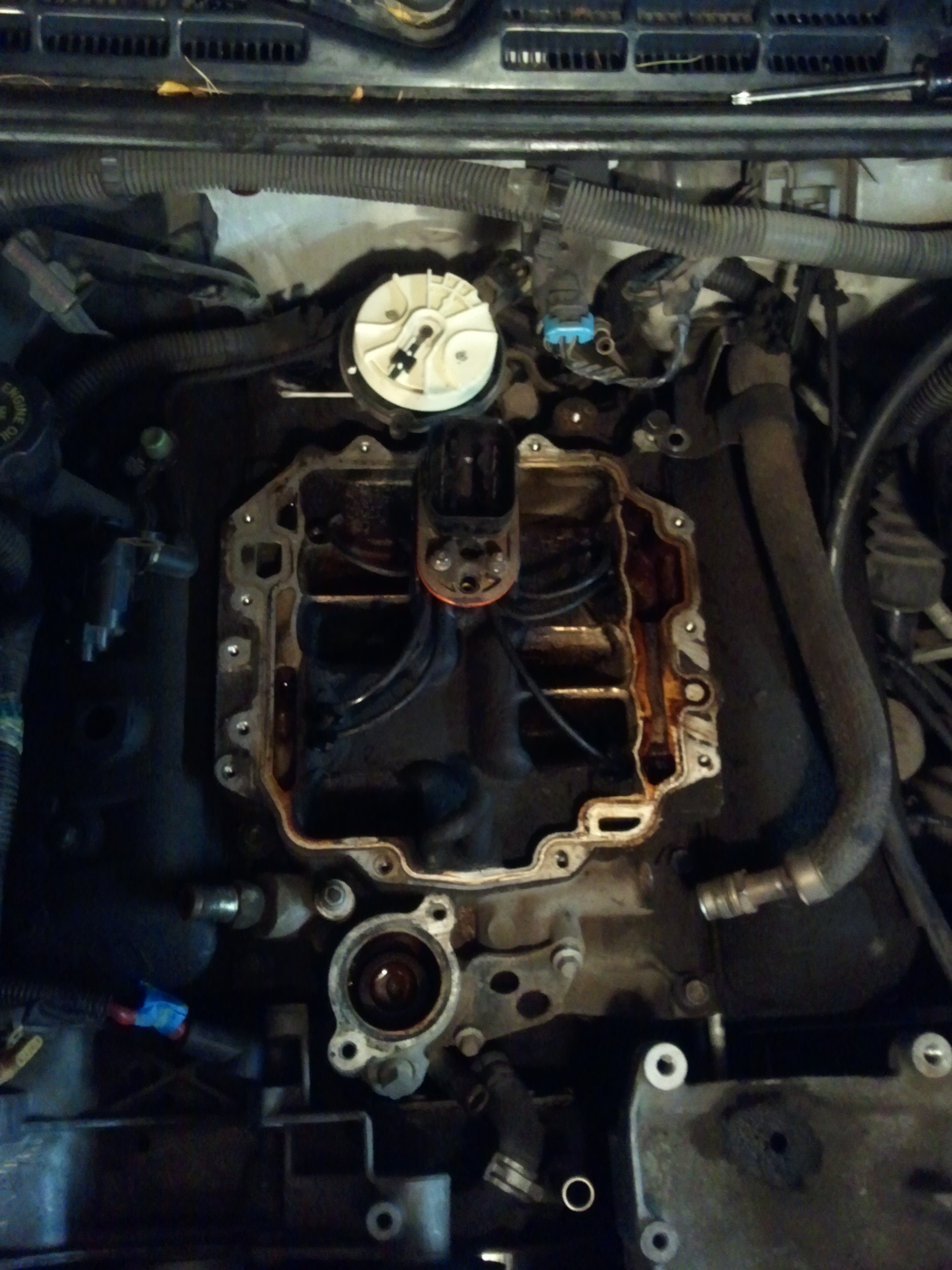

I've been tearing into the top of my motor in my 1999 Blazer (see below) with 135k miles to do LIM gasket and fuel injector upgrades. I'm attaching pictures of what I found inside the plenum and on the topside of the lower intake manifold.

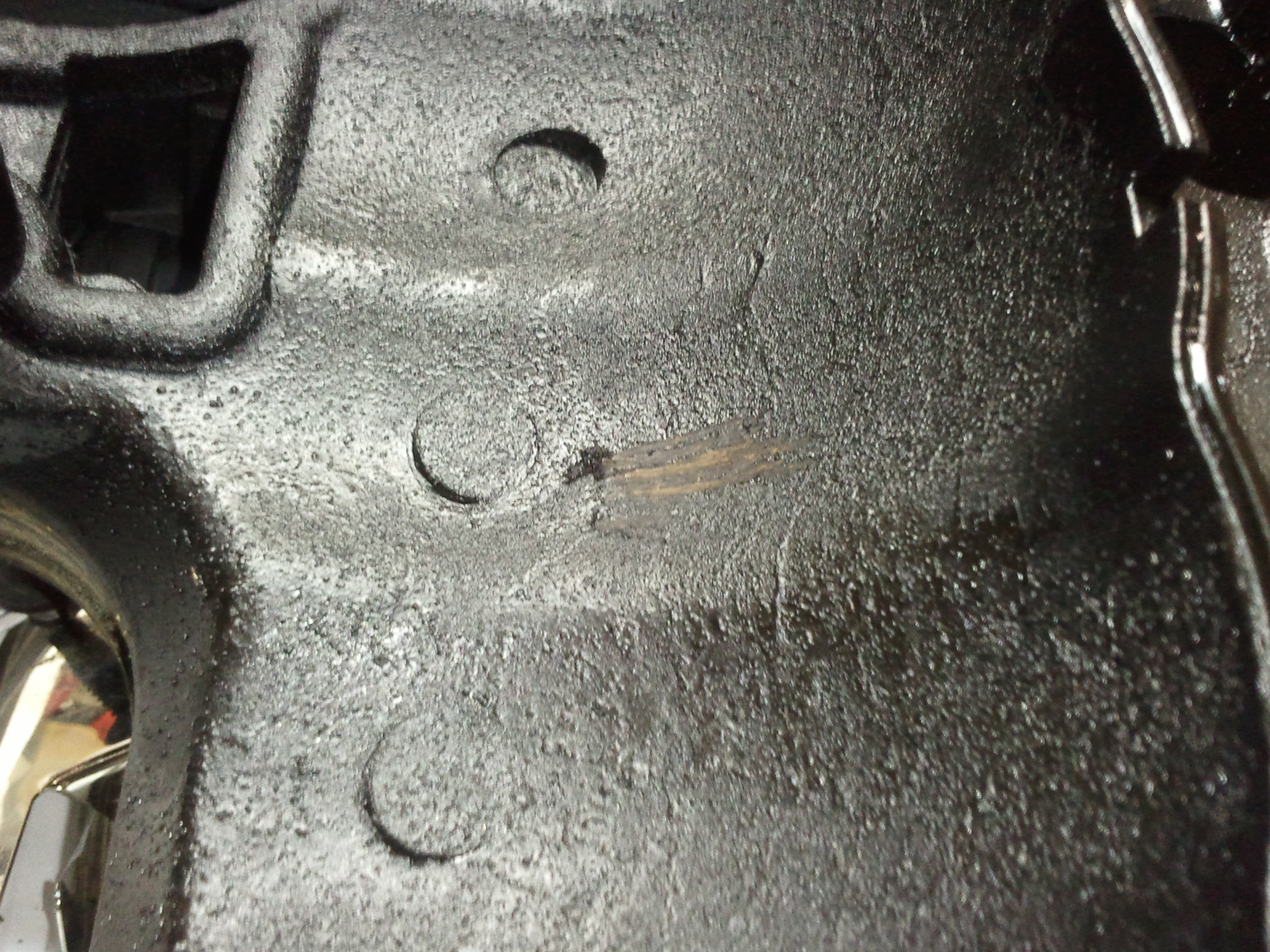

In words what I found was a coating of wet-carbon like crud. On one of the pictures you'll be able to see how it is not very thick by where I scraped it with the tip of a screwdriver.
Is this anything to worry about?
Would a degreaser and a brush be a good way to clean it all up?

don james 10-29-2017 01:02 PM
I can't load your pics???.........I tried with two browsers??
carbon build up is better than brown sludge........It should clean up.....carb cleaner .....maybe.....

Sorry about the pics not loading. :icon_shrug: I just tried the links now and they worked. The coating is less than a 1/16" thick if not half that.
That is a good hint with the carb clearner. I bet that is the way to clean it all.
