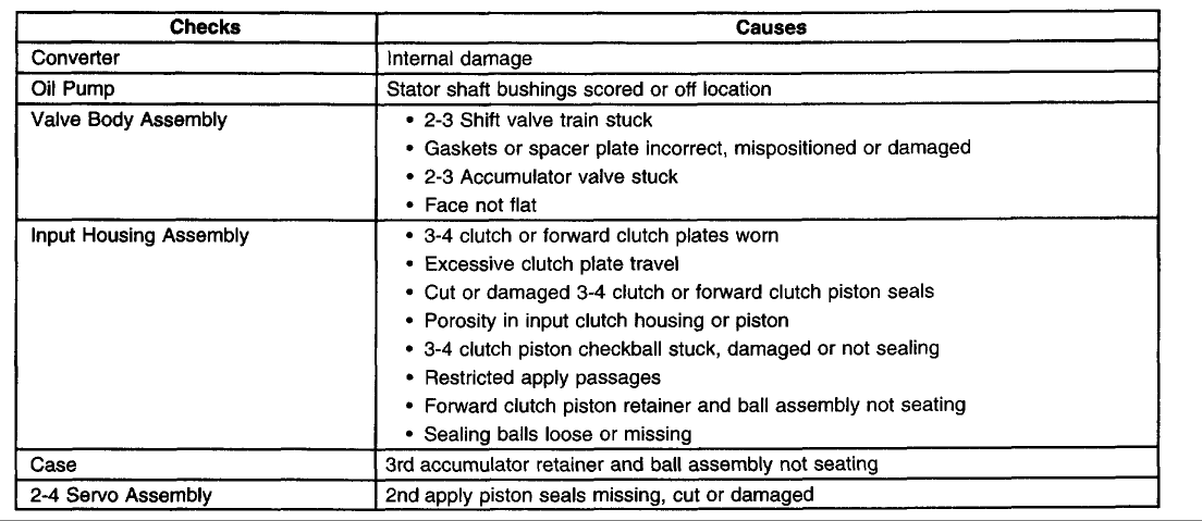

Holy crap man, calm down there!!! You are getting free advice here. If you want it on your time line, open up your wallet and pay a shop. Or else, be patient and we will get back to you on our time.
What are you really expecting to get out of this discussion?
Now, what does the fluid look like? Smell like? Is it full? When was the last time it was serviced?
As I said in my previous post, this could be internal damage to the clutches/bands or it could be a solenoid problem.
Here is the checks/causes listing for the "No 2-3 Shift or 2-3 Shift Slips, Rough, or Hunting":
