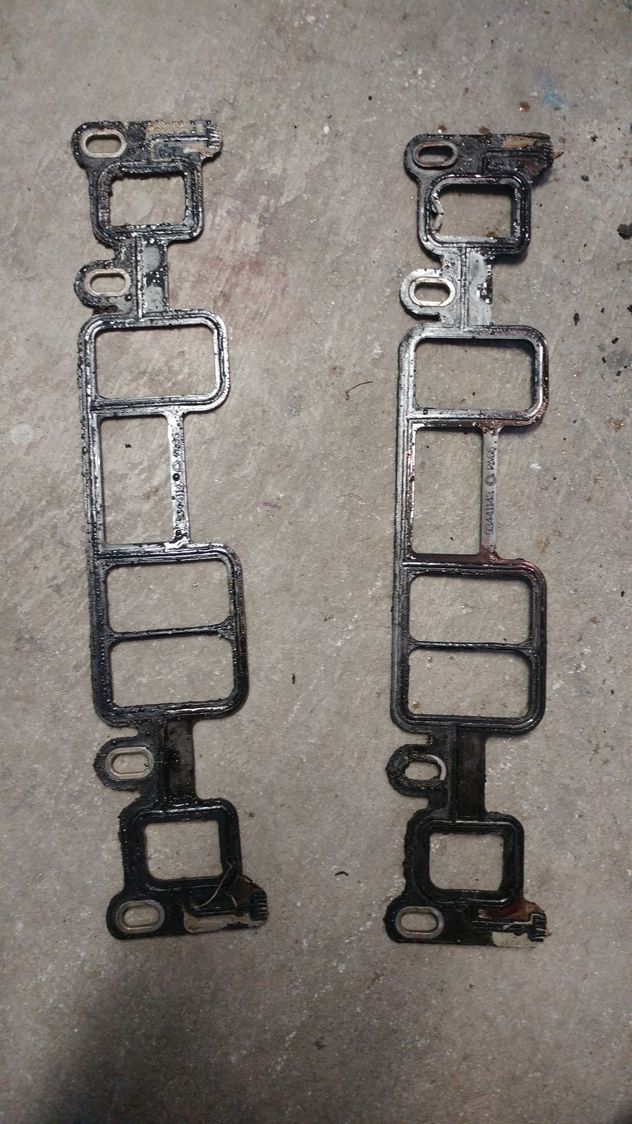

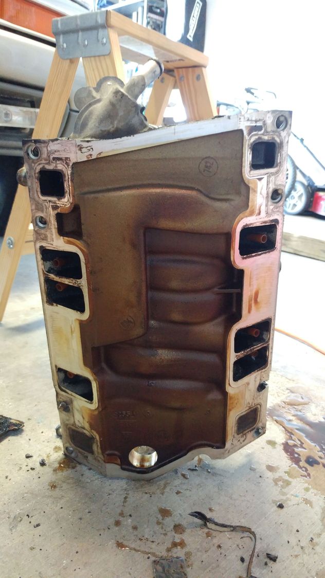

mech cb 08-12-2017 06:40 PM
https://cimg6.ibsrv.net/gimg/blazerf...2c8867380c.jpg
https://cimg2.ibsrv.net/gimg/blazerf...f33bd8cc22.jpg
Pretty clean, i dont see any heavy corrosion trails.
https://cimg0.ibsrv.net/gimg/blazerf...9ec5cce87a.jpg
Overall, they're still decent. I see some early signs of failure, but nothing major.
https://cimg9.ibsrv.net/gimg/blazerf...2e7d573118.jpg
Clean valves
https://cimg8.ibsrv.net/gimg/blazerf...8c6bf0ba49.jpg
Not even any buildup under the covers
