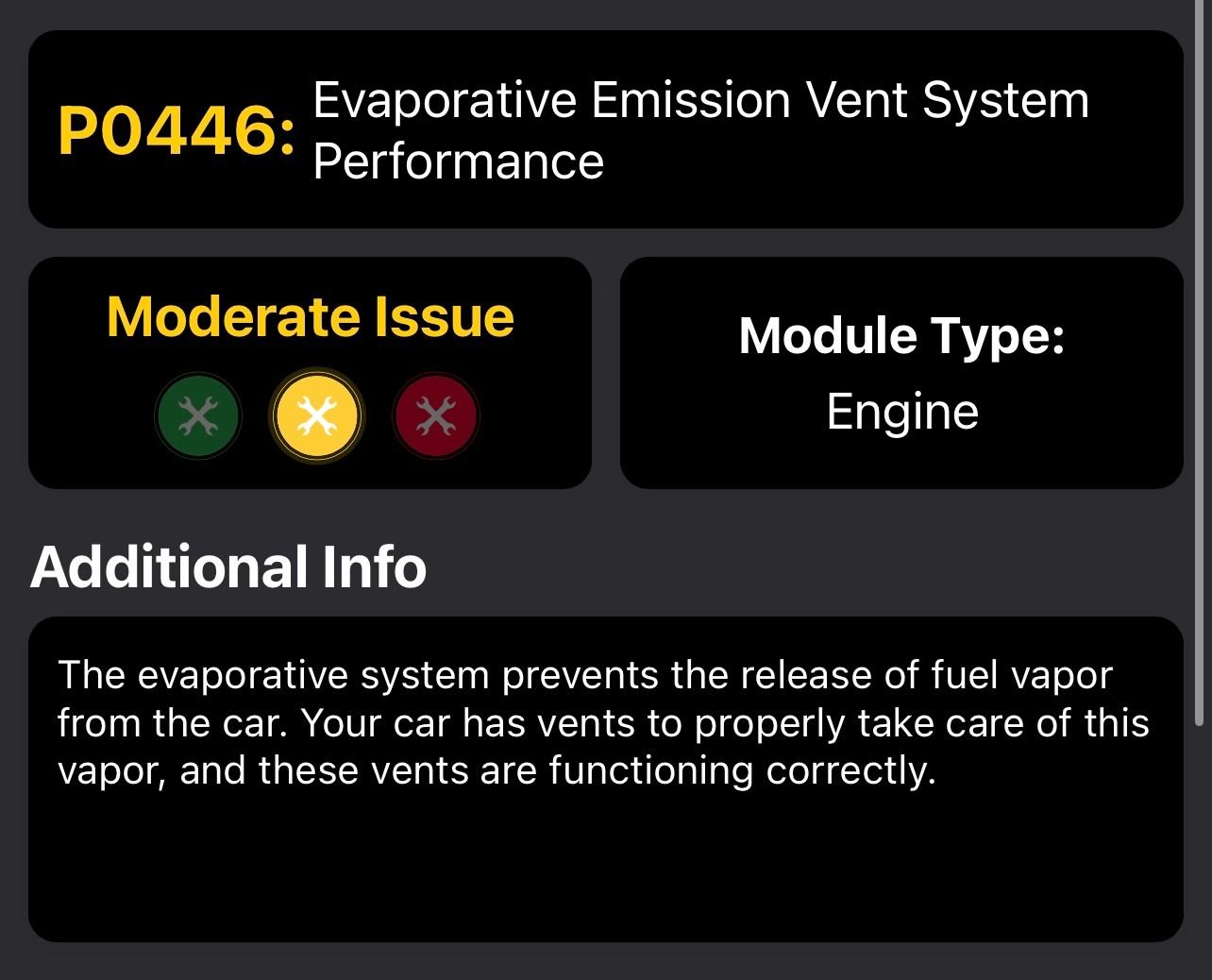

I have recently acquired a 2000 LT Blazer 4x4. The engine light recently came on and when scanned, shows a P0446 evap code. I’ve been told to check out the gas cap, which appears to be after market but clicks fine and the purge valve. The original purge valve appeared to be fine but I replaced it anyway. After a few drives, the engine light came back on with the same code. Anyone have any tips? Much appreciated. Thank you.
