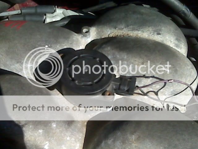

Now about that black thing on the top of the plenum: any info on that & what is supposed to supply power to it, cause neither wire shows power, and for some reason that doesn't seem right.

Lower_Level 09-04-2009 11:19 AM
Here's the part I'm talking about:
http://i62.photobucket.com/albums/h9...l/IMG00167.jpg
bigdaddykane93 09-07-2009 03:31 AM
thats the manifold tuning valve. it has a flap under it that turn when necessary. but i dont know why its there, or what it really does. i took mone off today to look down the intake penuluim and i found a little fliud that smelled like gas at the bottom of the intake on both sides... why is it there? is this fluid supposed to be there?
