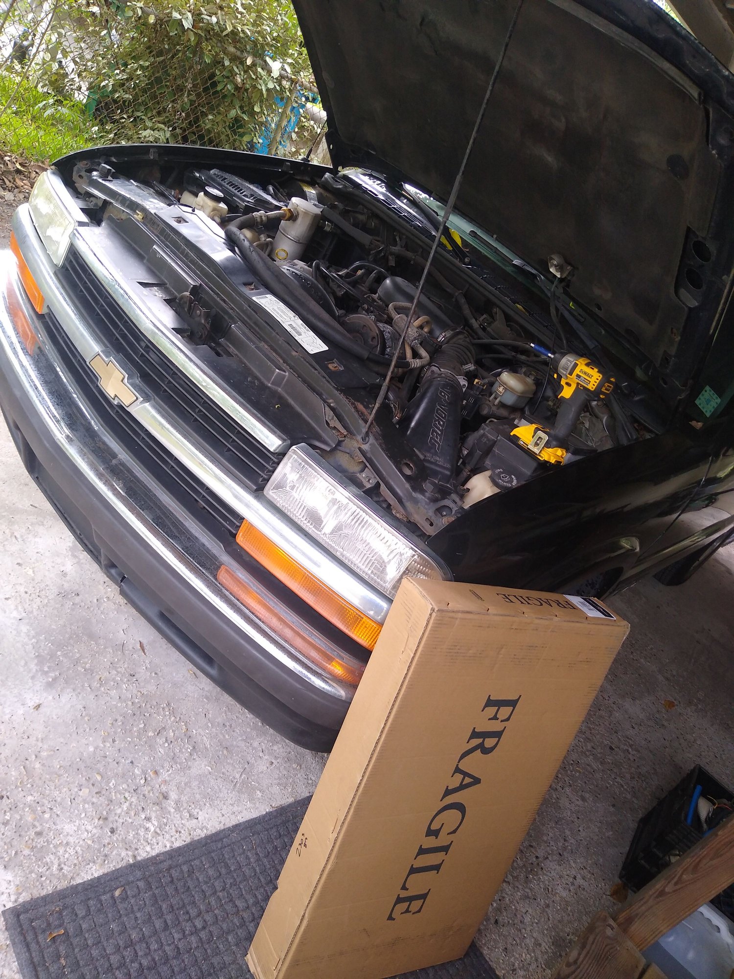

Hey guys , I'm just about to start on a radiator replacement and Blazer vortec 4.3 is there any thing that I should know before I get started anything crazy or just go by the Haynes manual and I should be good huh?

Haynes manual makes good kindling.
”While you’re in there”, things on my list would be:
- flush system
- new thermostat
​​​​​​- new upper and lower hose
- new water pump
- new serpentine belt
- 8 psi GM cap
Things I’d seriously consider:
- new fan clutch
- replace trans fluid while you’ve got the cooler lines off
