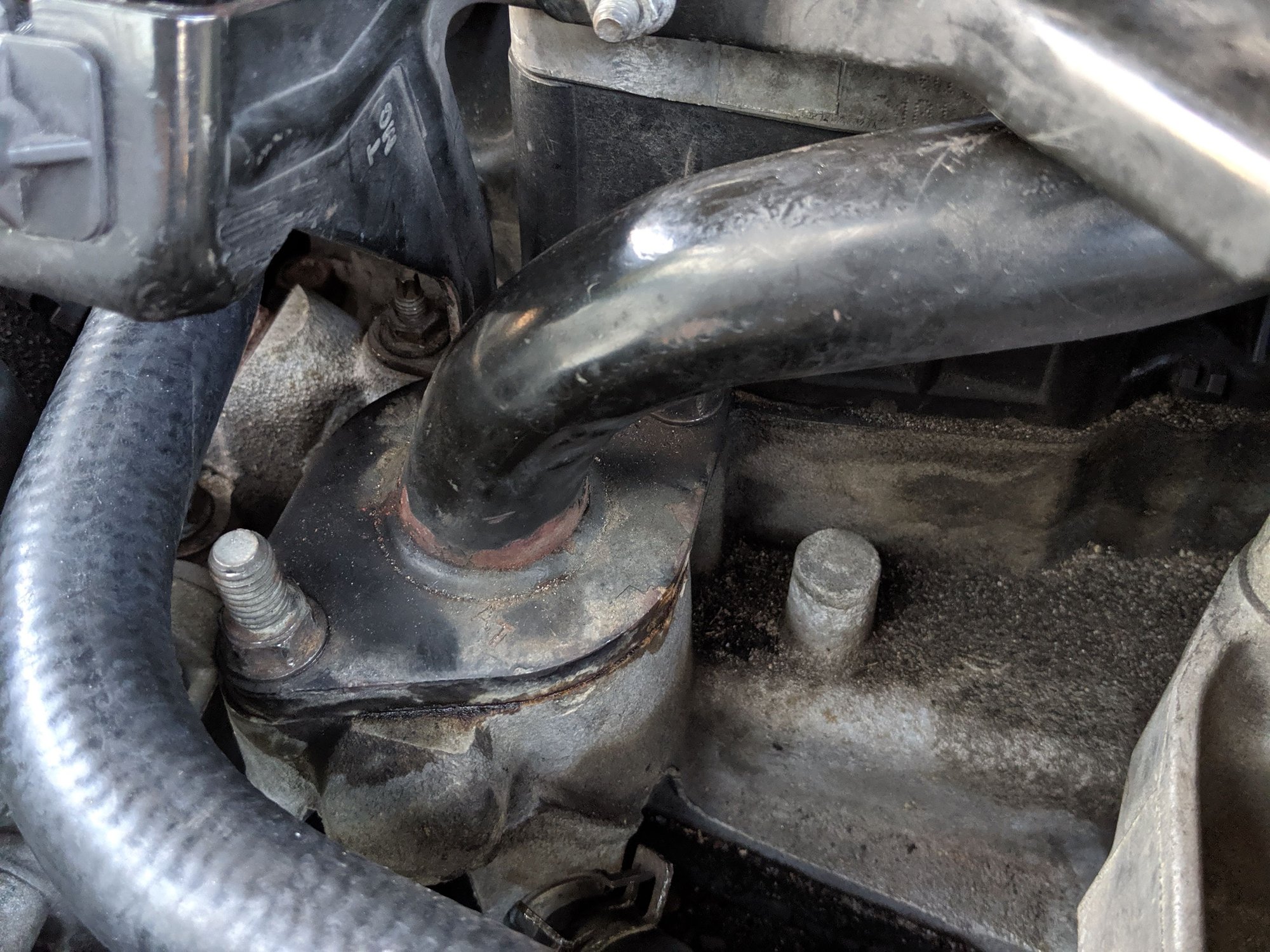

RedValor 11-11-2019 04:01 PM
https://cimg0.ibsrv.net/gimg/blazerf...3ab2ea5215.jpg
Does the 2002, 2-door, 4x4 model with the thermostat just above the water pump need a gasket? I saw a couple YouTube videos on this where they didn't install a gasket with the new thermostat, but that was for a different kind of S10 where the thermostat is off to the side under the airbox.
I'm asking cause I noticed a few wet spots around the thermostat hosing today. No hard leaks yet.
DonL 11-13-2019 04:56 PM
No gasket I know of, but there is a rubber ring around the thermostat itself.
