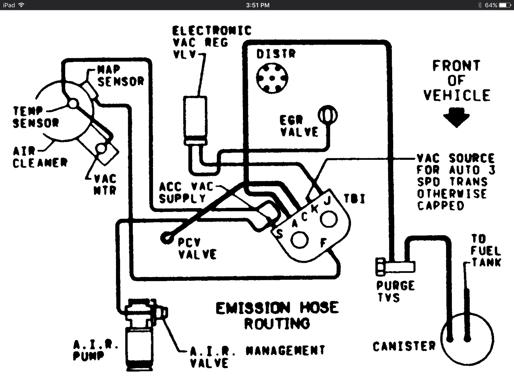

Does anyone have a copy of 1987 S-10 Blazer 4x4 2.8l TBI vacuum hose diagram?

I found this. May help.
Attachment 35663
run_girl Aug 3, 2017 12:15 PM
How about sizes of hoses? I would like to replace a few and I'm stuck in my office building and can't run out with a ruler! :)
Transman304 Aug 3, 2017 02:32 PM
I dont have access to that info,sorry. Maybe someone else will chime in.
