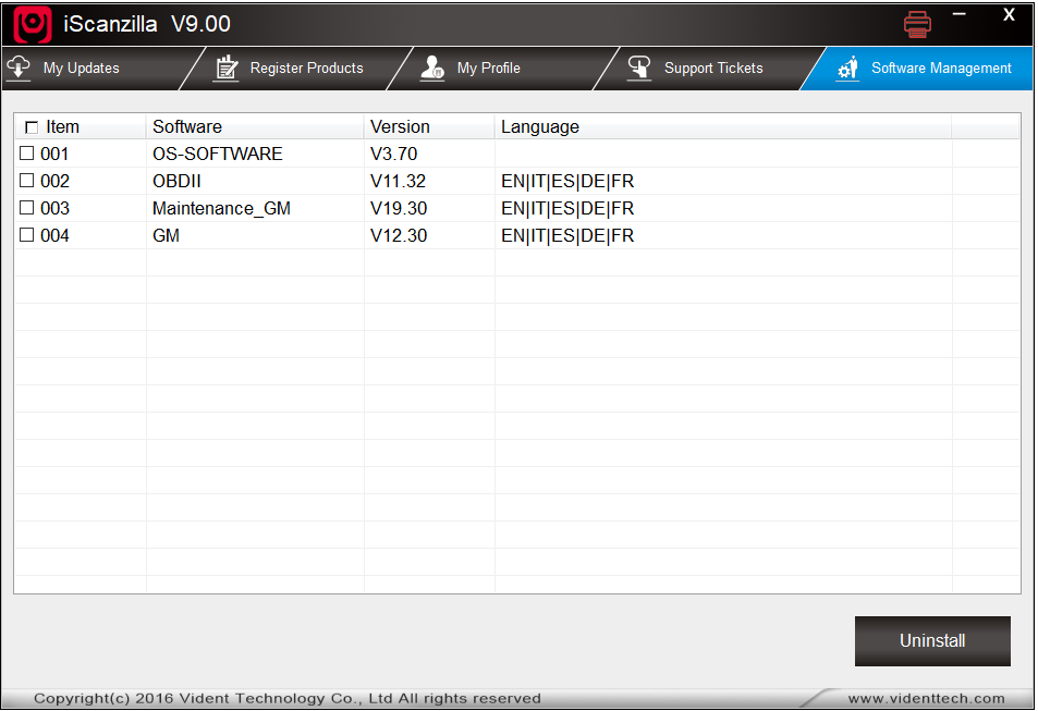

To prepare; I was looking over your instructions and it seems that your ilink interface looks different than what I have experienced when using mine (it is possible that I am not accessing the correct functions). Here is everything currently installed to my tool:
https://cimg5.ibsrv.net/gimg/blazerf...cbc221bf15.png
Does this seem to be everything I need or am I missing the PIDs? If so could you help me find the link on the vident site? Having trouble finding any downloads on their site in regards to PIDs/any software really. If needed I can get pictures of my ilink specifically tomorrow.
Again, thanks so much for your help.
LesMyer Jul 1, 2021 05:34 AM
AFAIK that looks right. Its been a while since I did this update on mine. FYI on the Ilink400 screen i started by selecting the GM icon (not OBD2 icon). If we can't otherwise resolve things i will post a video of how to get there on the scanner but I prefer not to have to do that.
