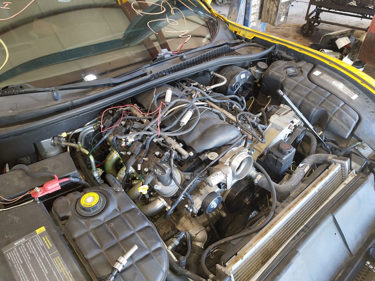

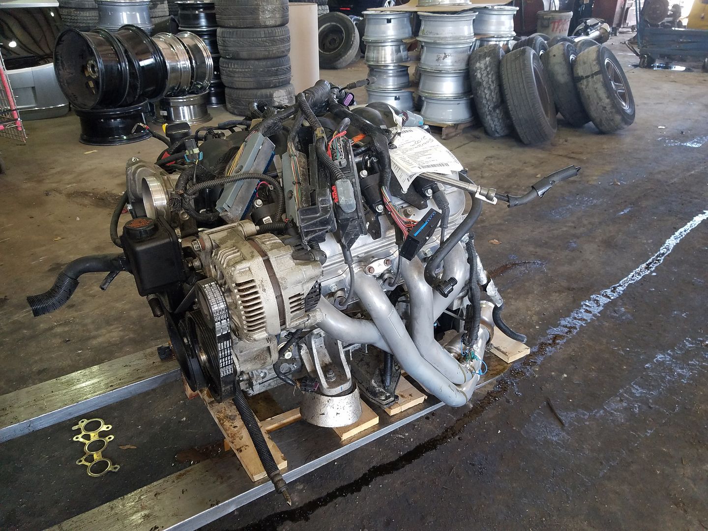

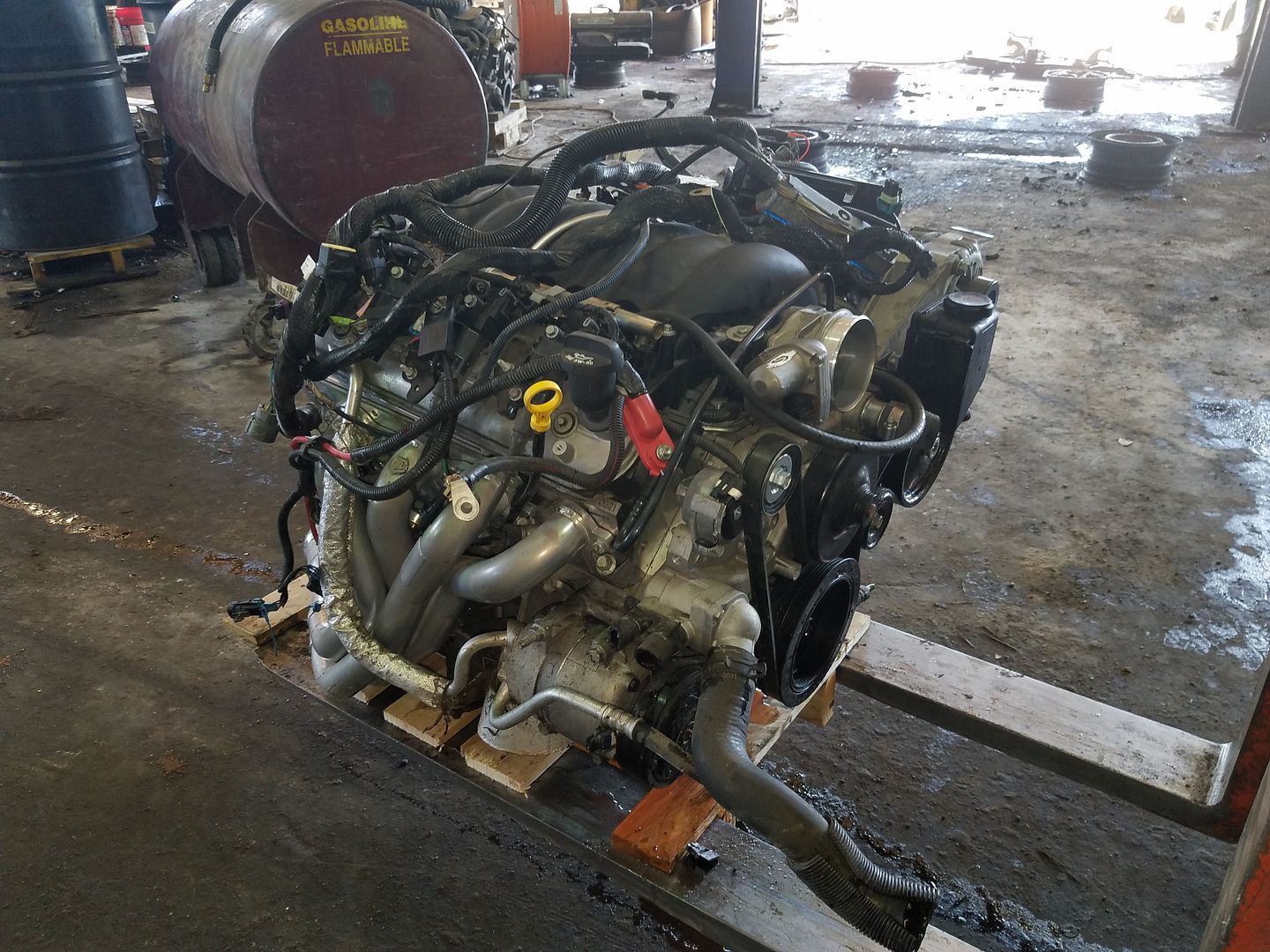

it's going to be a looooong term project, but this LS3 will get blown apart, rebuilt, and shoved between the frame rails of the 04
The car ran up on something and ripped a gigantic hole in the oil pan... It's not locked up, it will turn over by hand, but I'm giving it a full rebuild regardless obviously.

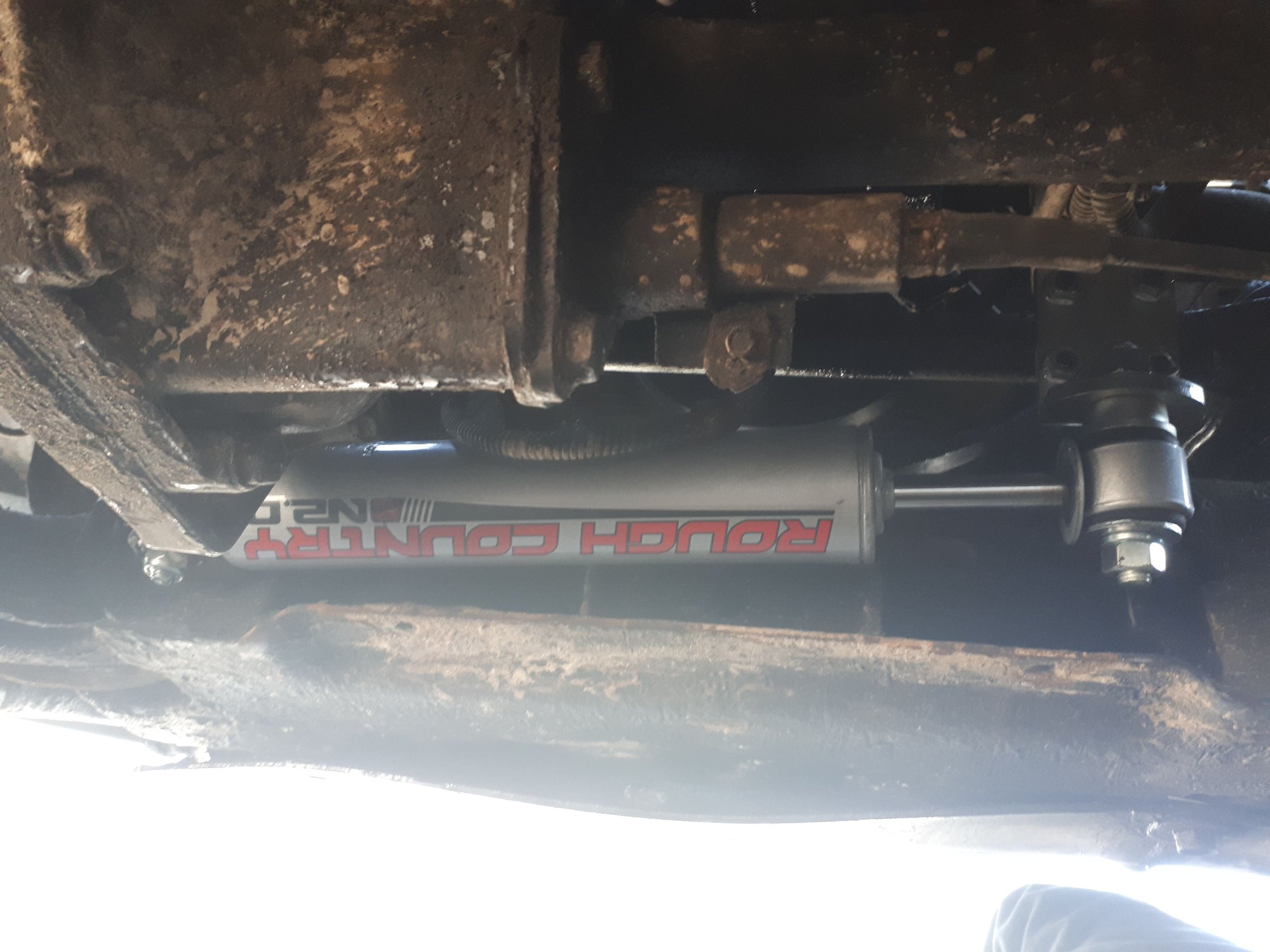

Been busy lately, so I'm a few days late on this convo lol.
got the lift kit installed over Easter weekend. I wasn' able to get the torsion keys swapped, but everything else is in. Also did the cv axles, tie rods, rear sway bar bushing, and a couple other small things.

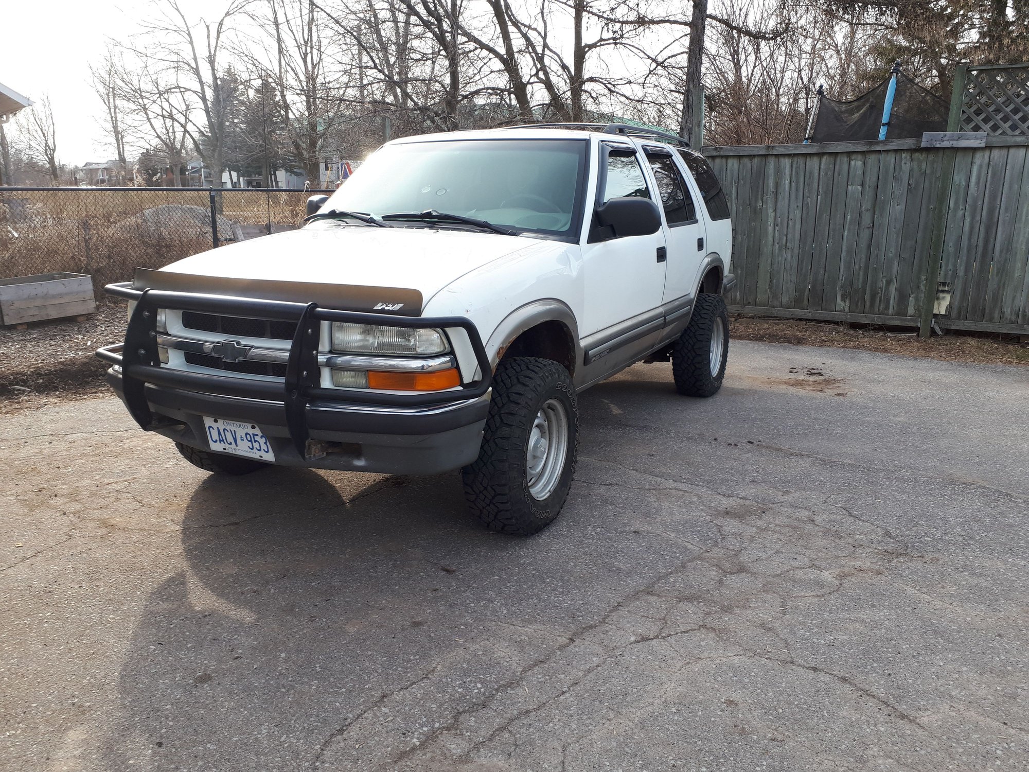

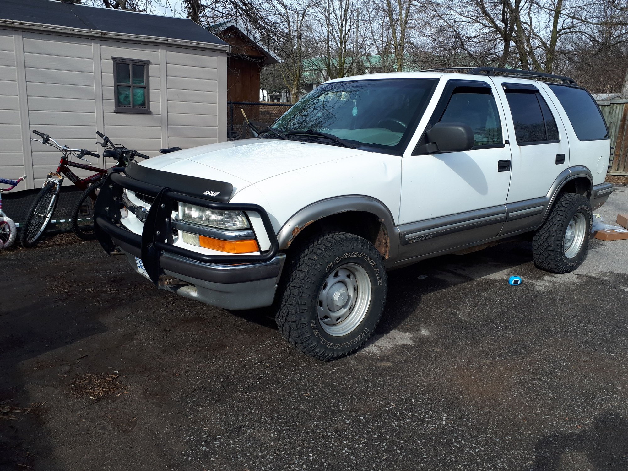

BEFORE: -5 1/2" FRONT -6" REAR
AFTER: -7 1/4" FRONT -9" REAR
PASSENGER
DRIVER
STEERING STABILIZER
REAR

Keep an eye on those rubber boots on your axles, at that angle they like to fall off.
And that is quite the angle on them.

I was thinking about doing hose clamps. They are new cv axles so I rather now before then later after.
I noticed the angle, but I didn' think it was that bad considering the angle I had with the torsion crank and no lift, it was way worst then now. But duely noted.
as she site now the shop pointed out how severe my Pitman arm really is. A couple more days and hoping to have it done. I picked up a puller for 30$. So gonna test that out and hopefully I can do it without pulling the steering box out.
