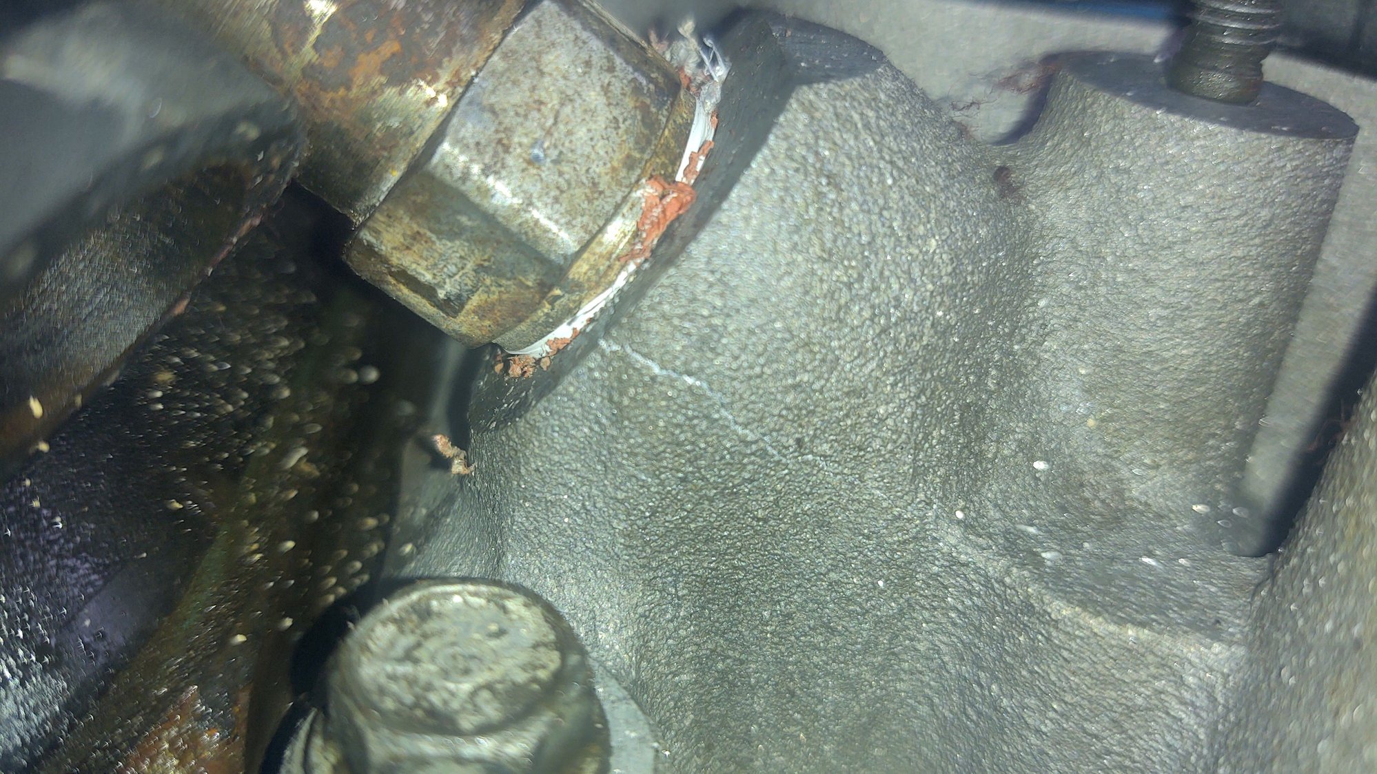

Well I done f-ed up now...
The heater hose fitting by the thermostat housing that was screwed into my replacement manifold had too small of a barb to go onto the Blazer's heater hose. The intake might have came off a Silverado or a van, I'm not really sure. But the fitting just unscrews.
I pulled the original one out of the old manifold, cleaned it up a little, put on some thread tape, and proceeded to thread it into place.
I guess I put a little too much torque into it... I was just about to the point where it felt comfortably tight, and then I heard a "pop" and the fitting loosened up...
Split my damn replacement intake at the threaded boss...
soooooo, the Blazer is down until I can source another one...

Ouch, damn that stinks. Look at it this way, it’s always a good excuse to get the better intake gaskets.
Do you have any friends with a TIG? I bet it would be an easy fix

I did that to a brand new Edelbrock intake manifold years ago. It was an expensive lesson.
FWIW, I think teflon tape has more of a tendency to do that than pipe dope or other sealants.
