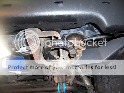

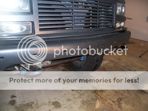

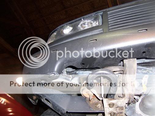

also installed my suburban hooks. <-- not as awesome as I had hoped, but should be extremely useful.
**EDIT**
pics added
before
after
difference
difference 2
finished product

nice hooks ABN, they do look a lot beefier, thats looks like 1/2" material to 3/4" material

yeah much beefier
i had to hog out the frame holes a bit (1/2" mounting hardware) and they are shorter (noticeably so) but should hold up to a hell of a lot since they mount into an anchor plate in addition to the frame rail.

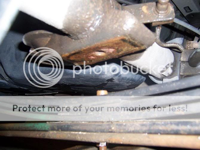

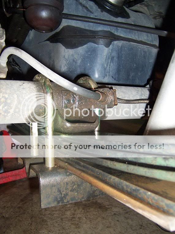

also swapped out my u-bolts since my leaf spring was no longer centered on the D side...
this peg had slid OUT of it's notch
the "peg" is the top of the bolt that holds the spring pack together. the peg fits into the bottom on the spring perch where it sits on the axle. mine had slid out of it's home (probably due to hard sliding on iced asphalt) due to one of the nuts comming off of the outside u-bolt...
nothing some new larger dia u-bolts can't fix
