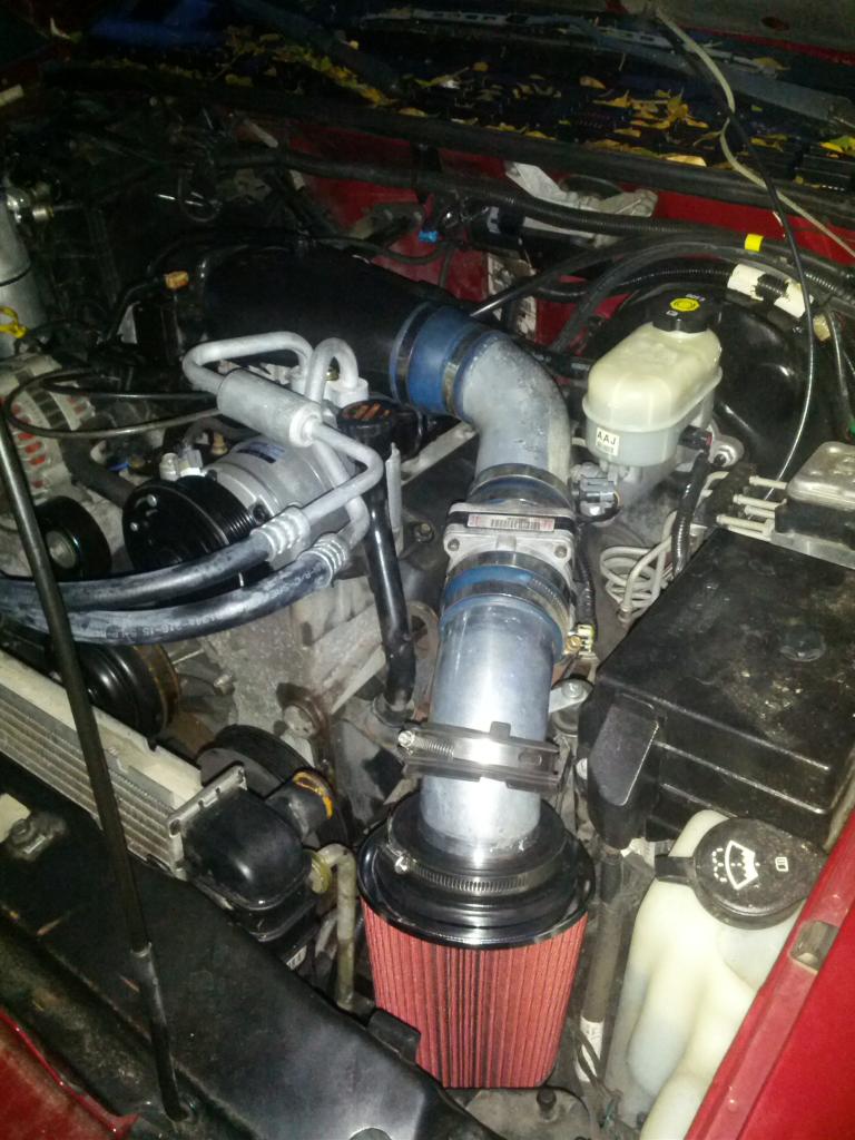

blazen_red_4x4 05-13-2014 08:29 AM
You wouldn't gain much from a filter setup like that. In fact it would probably do more harm than good... Let's say that you DO get the crankcase ventilation hose, air intake temp sensor, and air flow meter somehow relocated to work with it, and let's assume that there would actually be enough clearance for the hood to shut, you're just going to be scavenging hot air coming up from the engine and accumulating at the hood. Plus, moving all the sensors around would probably cause all kinds of issues like MPG, power, rough running, and more than likely throw the check engine light on. There's a reason quality aftermarket intakes keep the factory sensors close to their factory location.
Best option is a cheap kit online with a cone filter if you just have to have some sort of aftermarket intake. I got lucky to find one in the junkyard I work in on another 4.3 Blazer and I just bought a new filter for it. Uses factory plastic elbow that sits on the throttle body so that keeps the crankcase ventilation, has a port in the tube to accommodate the intake temp sensor, and the air flow meter is easy enough to attach with just a couple of couplers. Keeps the two sensors close to factory locations.
Granted, this type of intake isn't going to do much for power or MPG either, and I knew this going into it, but it at least shouldn't hurt it... About all it's going to do is make a deep throaty sound when you step on the skinny pedal. And I'm fine with that :)
https://blazerforum.com/forum/attach...ine=1399774460
