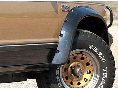

My blazer is a 93 S10 blazer. With the 2,5" kit IŽll use my stock rims and 31" MT tires, also i want to add 2" spacers too. But i think that you can cut a bit and install bigger fender flares so i can get enough space for 32" like the picture below. I dont want to install a BL,

Thanks for the info! I too will probably do the RC 2.5 since it's the most economical. It also helps to know I could put 31's on stock rims! I doubt seriously if I'll get into a SAS, unless I luck across what I need for the cheap. Have WAY too many other things to take care of like electrical, windows, suspension, tunes, body, rubber, vacuum lines, and the list goes on. Which MT's are you looking at and can you post some pictures of your Blazer?
