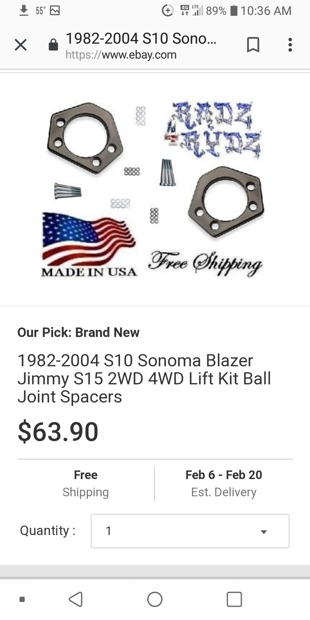

Thank for the info first of all.I will definitely check with Rough Country on that today,along with the replacement boots.Just out curiosity what did they charge you for the control arms? I have always thought it would be nice if they sold just the control arms. I have found a company that sells upper balljoint spacers to get the same effect as the longer control arms but in order to use these spacers you have to also use 16in rims so this is wonderful news.
https://cimg7.ibsrv.net/gimg/blazerf...7b7a01c039.png
This is the spacer kit i found on ebay
newguy 02-16-2019 08:02 AM
I did everything your doing, including the BJ spacers, nothing but trouble. BJ spacers ended up cracking upper control arms. Also by spreading the control arms they rubbed on the rims. And 33 inch tires will be to big. You will have rubbing and have to do some cutting of your fenders
Jeromy37 02-16-2019 08:32 AM
Yeah I've already cut the lower rear portion of the fenders and some of the fascia so that's not a big deal there.And yeah I was already skeptical of the balljoint spacers, so I'm glad I haven't wasted the money on a set.thank you for letting me know about them.what size tire are you able to clear on yours?Also do have the body lifted as well?
