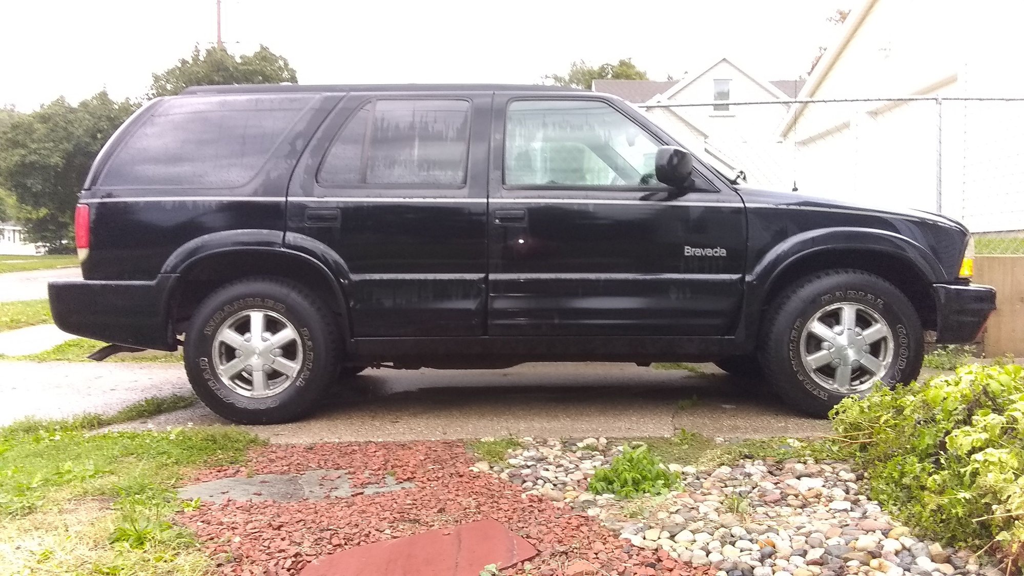

Bravada Baseline...
https://cimg7.ibsrv.net/gimg/blazerf...1d1d4d1538.jpg
current stance trying to stay as level with the camera as possible. driveway is slightly downhill rear but so is the sidewalk I'm squatting on.
https://cimg0.ibsrv.net/gimg/blazerf...a4300a5c8f.jpg

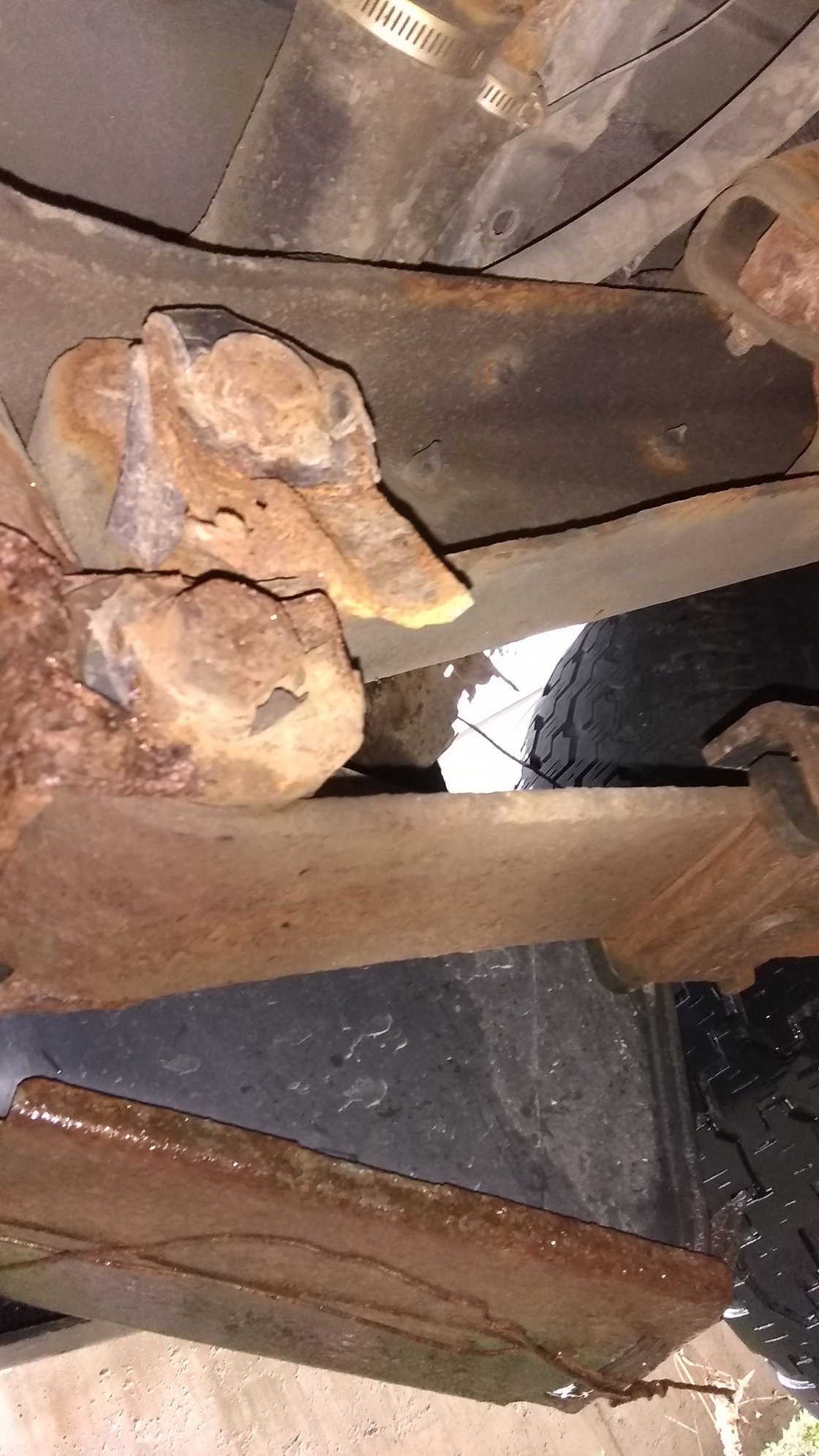

right rear previously replaced.
https://cimg3.ibsrv.net/gimg/blazerf...d6d327914c.jpg
left rear needs replaced LOL so does what's left of the EVAP bracket.

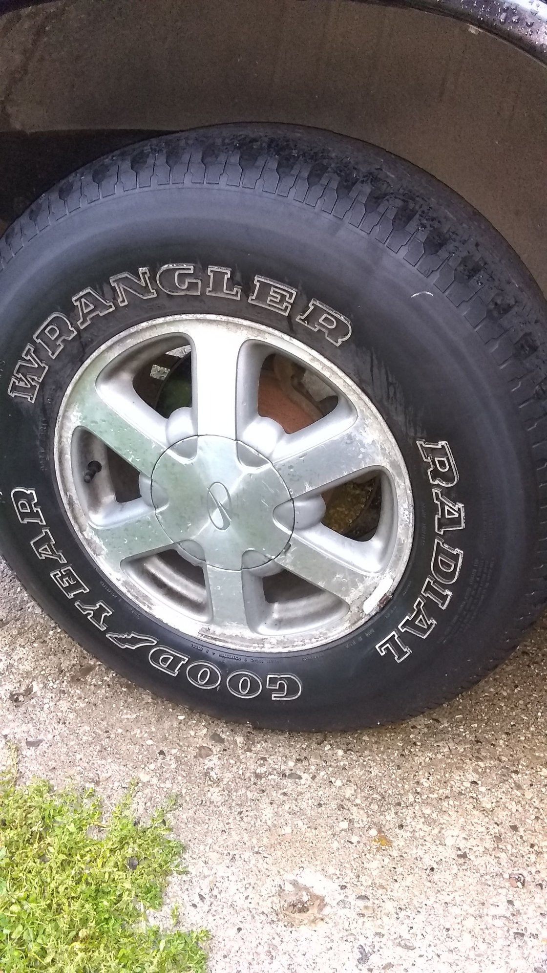

https://cimg4.ibsrv.net/gimg/blazerf...868c808c63.jpg
current rubber is relatively thin and 235 75 15

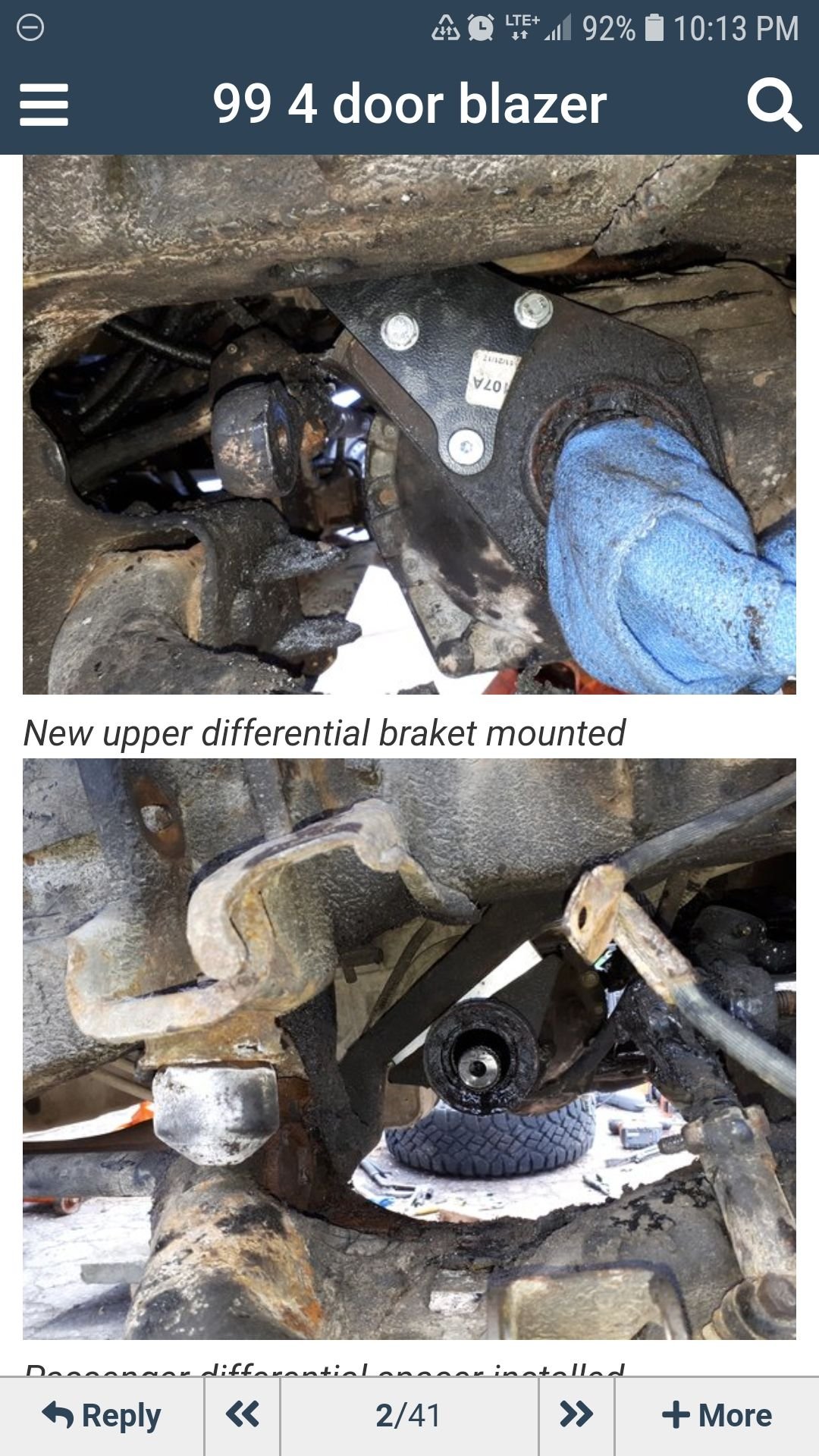

thank you guys! DonL, what is the drop bracket and adapter plate? Christine how have your superlift front shocks held up? been about 3 years?
DonL 09-01-2020 09:16 PM
It's just an aluminum wedge, and a plate that adjusts the angle of the diff.
here's a pi of them from my build thread. I've seen them in sale on Ebay.
https://cimg4.ibsrv.net/gimg/blazerf...4a8034050c.jpg

so I may not have a paperweight after all, call me crazy for not realizing that a simple repair would actually affect about a 1 inch lift.https://cimg6.ibsrv.net/gimg/blazerf...3eb748bb51.jpg
before repair stance.
https://cimg8.ibsrv.net/gimg/blazerf...0d15191e14.jpg
amazing what an Intact shackle will do LOL
