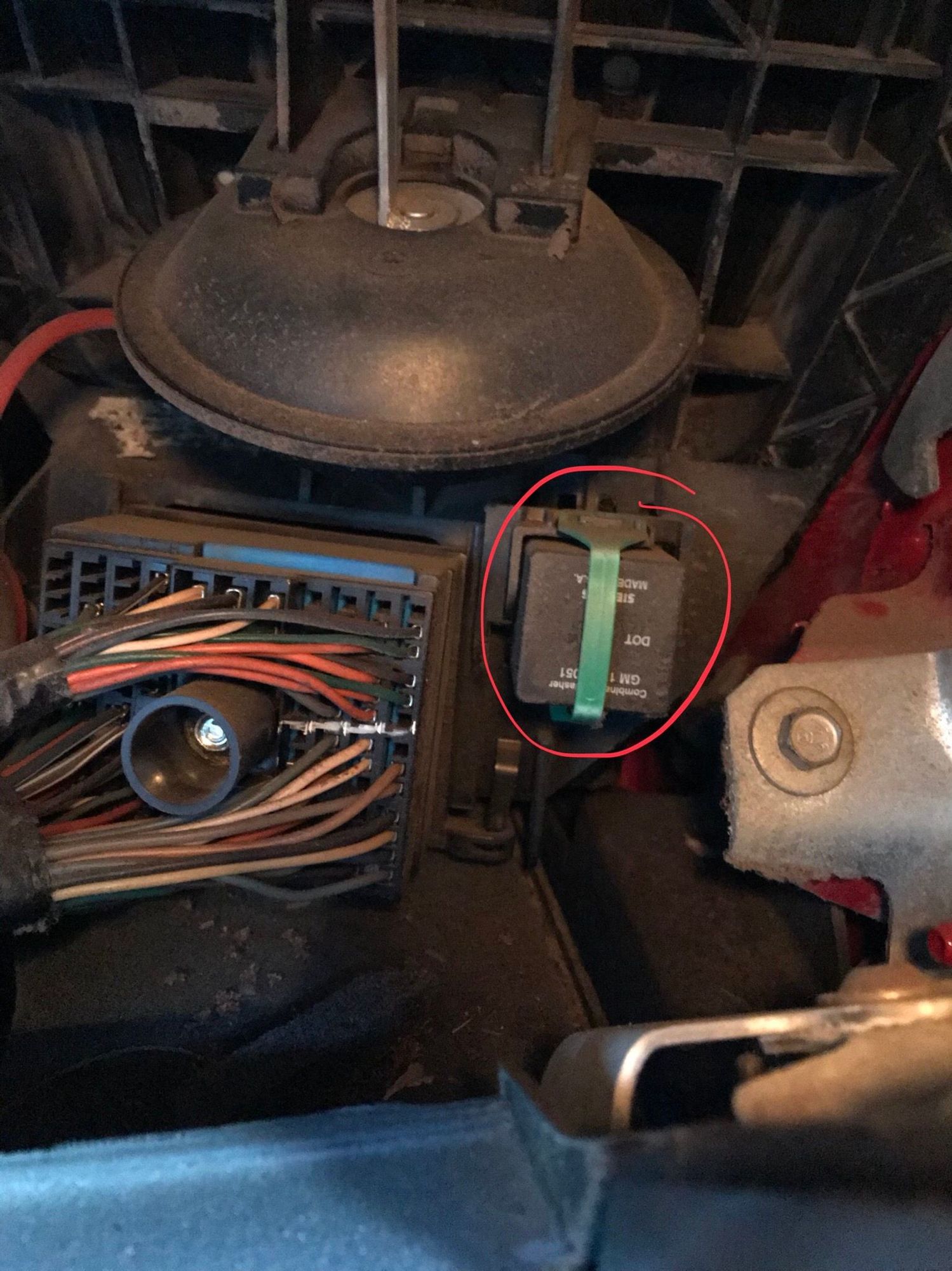

OK, it is the relay behind the glove box. See the picture I attached. It's the ones in the red circle. https://cimg1.ibsrv.net/gimg/blazerf...effbedec1.jpeg
rockp2 05-16-2018 10:30 PM
1 Attachment(s)
I'm not normally one that says change a part without further testing, but I would slightly lean towards suggesting you replace your multi-function switch. :)
First, it is probably one of the top failure points on these trucks.
Second, I had the same exact situation/symptom and a new multi-function switch fixed it. :)
EDIT: I should further point out that the problem seems to lie in the internals of the switch itself and there are so many circuits involved with the switch, not to mention the Body Control Module (BCM) logic, I can't say for certain if normal troubleshooting would yield definitive results on this. If you want to try and diagnose, you'll need a DVOM, a test light would be nice, and a good wiring diagram...and patience. I/we can try to work with you on it. Who knows, maybe it's just some dirty contacts.
I really hate to say just replace the part. The thing runs ~$100 or so.

Wow, that's familiar. My wife was just showing this issue to me yesterday. Is this relay clicking with ignition shut off? It didn't seem to stop, at least not while we were sitting there. Opening the door and getting out seemed to stop it. Not doing it this morning. Does anyone know what the relay is actually for?

The relay is the Turn Signal Lamp Flasher. But that part is not the problem. With no hard data/tests to back up my assumptions (besides changing the Multi-Function Switch and the problem being solved), the issue seems to me to be a result of an internal circuit problem of the "Hazard" part of the Multi-Function Switch. I kept my old one for about a year on the shelf and was going to delve into its circuitry, but never got around to it and ended up tossing the bad part.
I did not experience the problem with the ignition switch off, but if my assumption is correct, in that it's a circuit problem with the "Hazard" part, it could make sense that the problem could happen with the ignition off. But, that is only speculation at best.
