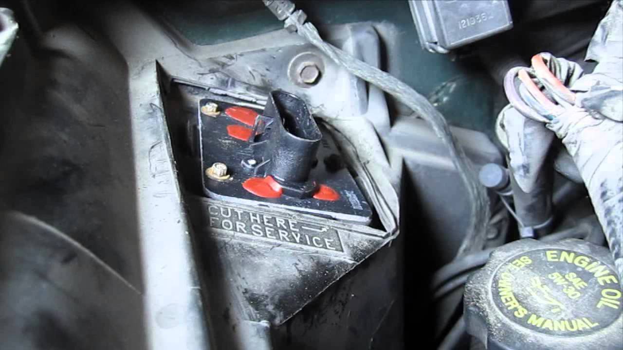

MountainDew Sep 24, 2017 08:58 AM
Im having trouble following what exactly the problem is but from what you have replaced and what I know is the most common thing that screws up is the Blower Motor Control Module-Resistor. This thing
https://cimg4.ibsrv.net/gimg/blazerf...629fea0e9f.jpg
its out in the engine bay mounted next to the heater blower motor.
if this is something you already replaced my bad.. so many modules, relays it is easy to mix things up.
