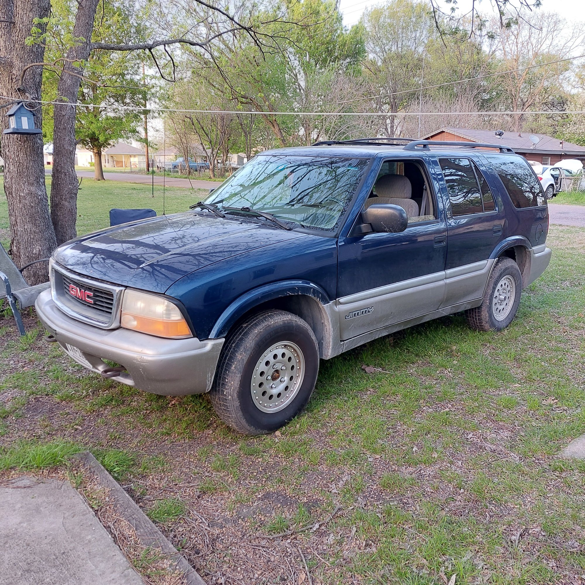

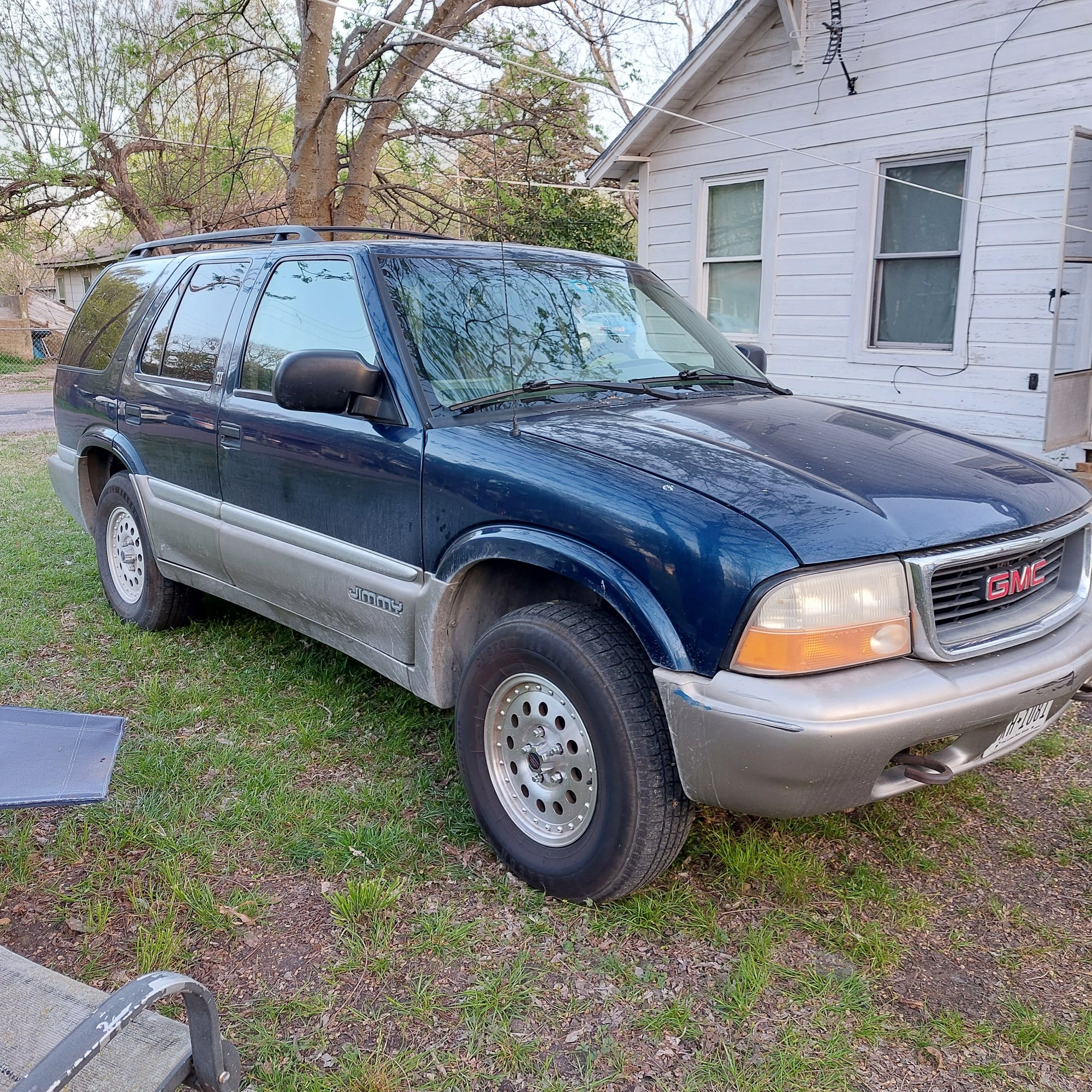

cage47 Mar 31, 2023 08:30 PM
https://cimg5.ibsrv.net/gimg/blazerf...ed968eb85b.jpg
https://cimg9.ibsrv.net/gimg/blazerf...c1d21d145c.jpg

Opinions wanted: I've got the blazer til noon tomorrow when pickers comes to junk it. Should I leave the american national rims on? Or should I put the stock blazer rims on? Both sets of tires have comparable tread. I'm kinda torn. Wish it had the original Jimmy rims. These are close. But kinda like the blazer style. (torn)
