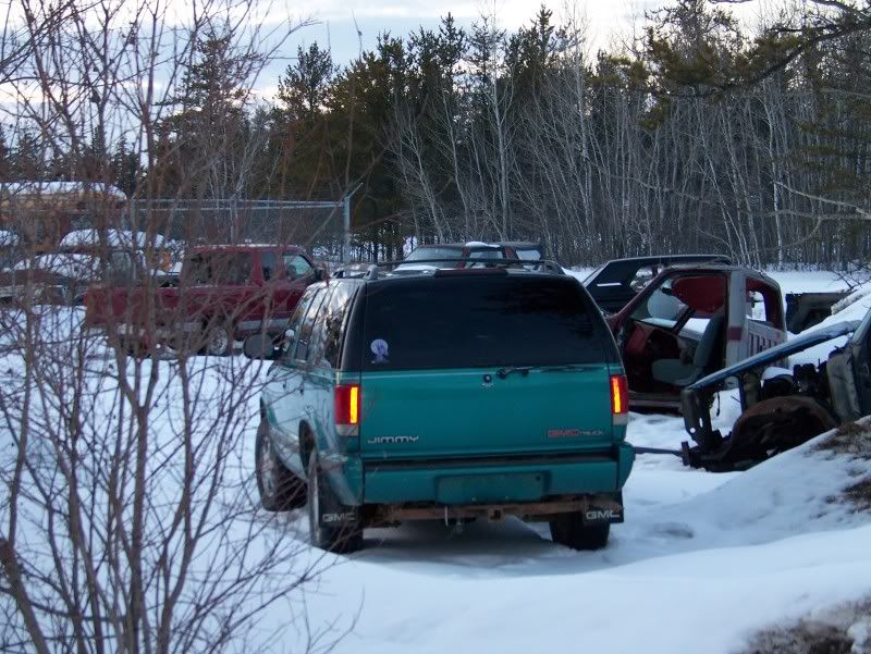

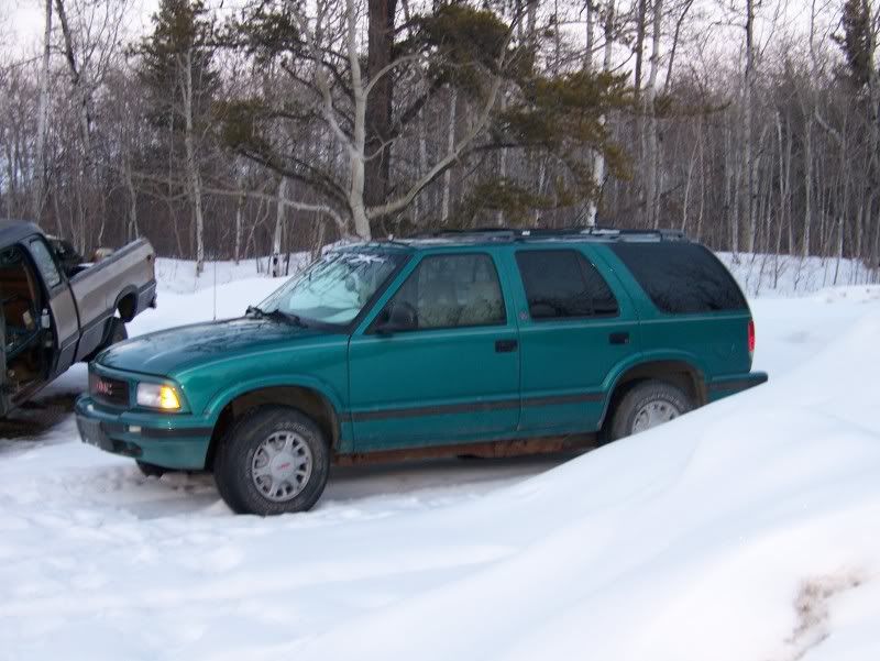

Just got back from looking at a '96 Jimmy and what a score! Needs freeze plugs, everything else works well including the 4wd, no body damage, only rust is from a chip in the hood and a little surface rust on the drivers side front corner of the fender near the hood. Interior is a bit dirty but nothing a good cleaning wont fix. All this for 300 bucks, I'm a happy camper. In the add it said good beater, it looks too nice to be a beater, so it'll get a good polish and cleaning and it will be my winter truck since my 2wd crew cab just doesnt cut it where winter lasts 6 months long...

Just got it to my shop. it was quite an ordeal! The Jimmy was frozen into the dirt where it was parked in the fall and we tried everything to get it out including lifting it by the front hooks with a tractor, pulling it out with the tractor, etc. The truck wasnt running, just cranking over so we couldnt try to get it out under it's own steam. Finally about an hour later I saw somebody had left the parking break on! It came out easily after that. After the tow truck brought it to the shop it started with minimal cranking, no issue because it needed to be towed regardless because of the freeze plug leak. Runs very smooth.
Body has minimal rust, just light surface in a few spots that paint had peeled, and one dent in the driver's door that looks like I can pop out from inside. Interior is very dirty but thats easy. Overhead console doesnt seem to work, I'll chase wires later.
