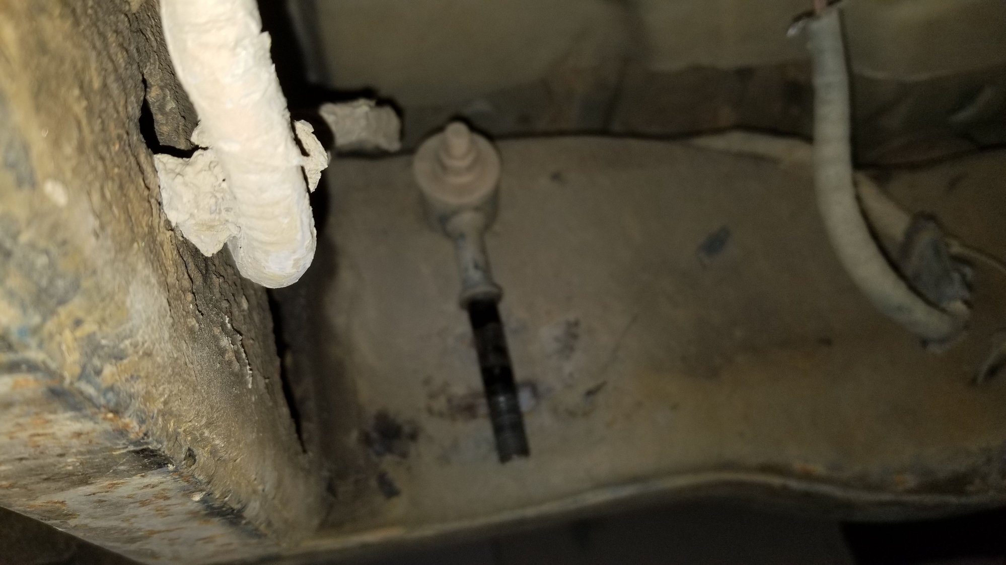

The bolt is accessed through a hole in the frame:
https://cimg3.ibsrv.net/gimg/blazerf...46a1803251.jpg
Be careful when removing this bolt, so as to not drop it inside the frame!

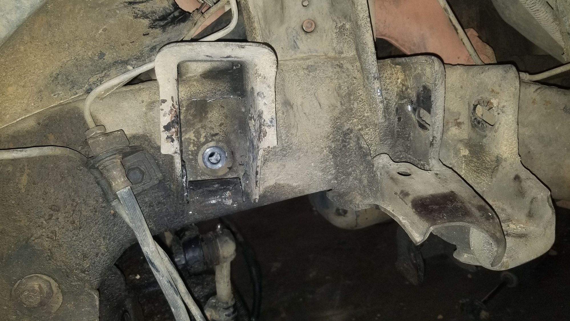

There are three locations the diff is secured to the truck. I began by removing the two bolts on the passenger side axle tube. These are the easiest to get to. There is a bolt and bracket at the bottom of the diff housing. Remove that bolt, and cut the bracket according to the instructions:
https://cimg9.ibsrv.net/gimg/blazerf...278e93090c.jpg
Not the best picture, but there was an "L" shaped piece on the right side of that bracket. This must be removed in order for the diff to come down.
