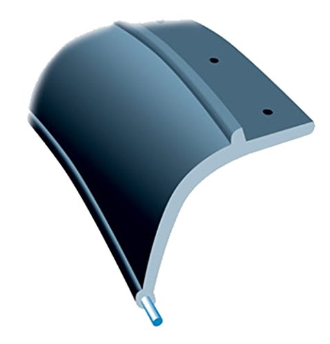

Fender Flares (sort of)
Has anyone used/seen/have any info on these? $60 on amazon.
https://cimg9.ibsrv.net/gimg/blazerf...2fed3046dc.png
https://cimg3.ibsrv.net/gimg/blazerf...3e286883b8.png
