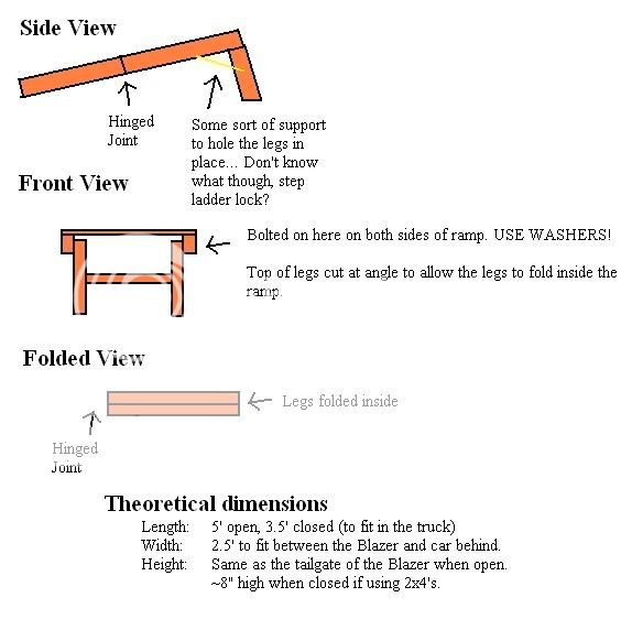

I was thinking this... lol, sorry about the drawing, would have been simpler had I used autoCad. It's a rough idea, and theoretically it could be used to allow the dogs to climb through the back door after dropping a seat to allow them entry. (This is if there isn't enough room behind you.)
I'm sitting here shaking my head though, because what I would have made with Cad would have had your dimensions on it and would have made your life easier. Thi is also a little disappointing in my mind.

he there, thanks for the drawing. Looks fine, but entering through the back door is not an option. They have to enter through the tailgate, because there is a luggage-barrier above my back seats. This prevents the dogs from getting to the front during driving and during a crash.
So entering from the side is no option.
I am thinking about building myself a tailgate-step.
If you have any other dieas, they are welcome. thanks for the effort.
