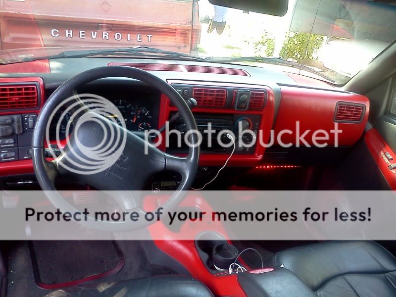

Thank you everyone!!! I did it and it turned out great!!! I bought 2 cans of Rustoleum Plastic Paint Glossy Red from Autozone. I washed each part with hot, soapy water... let them air dry... then applied 3 coats to each peice. Here is a picture of the completed project!! (I also added 2 strips of red LED's in the leg area up front and in the dome light!)
http://i62.photobucket.com/albums/h9...824_112228.jpg
warthogdriver 08-24-2011 03:04 PM
that looks great...i hope in your description you accidentally left out "...i sanded and primed.."
or you may have some problems down the road.
otherwise like i said...great job

I actually didn't sand and prime anything, just cuz I didn't know what it would do to the texture on the plastic... but Im not even gonna be able to drive it after the beginning of next year cuz I joined the army, so whoever I sell it to, it's their problem lol.
