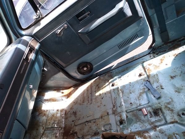

Update: So it looks like the wire brush drill attachment just shredded the mat a little bit but didn't do much for ripping it free from the body. The heat gun would probably work well, but I don't have one. I considered using the wife's hair dryer, but I know better. What wound up working the best was a razor blade scrapper, some gloves and a whole lot of patience. I was able to get about 20% of the passenger side deadening pad with a 1" scrapper, but the razor blade worked much better and got me to about 90% - about 2mm at at time.
This is the driver side deadening pad. I need to take the driver seat back out to get the good angle and slip that razor underneath the last of that stinky mat.
This is the 90% on the passenger side. Pretty excited to get all the old crap out of there.

I love how clean that floor is! I dont see one hole.
