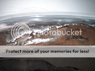

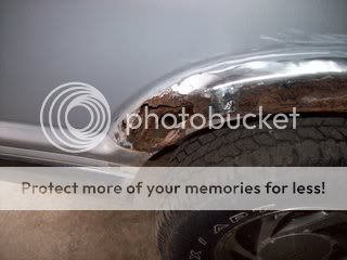

ok my blazer project is going to be a little tougher than i thought. i need opinions on how i should go about fixing this..this is the only bad spot on the truck other than the rocker panels..would you glass it in or what..i want something that's going to hold up in Michigan winter..i would cut it out andadd a new piece but i dont have access to a welder..here are some pics.
http://i880.photobucket.com/albums/a...zerpics001.jpg
http://i880.photobucket.com/albums/a...zerpics002.jpg
http://i880.photobucket.com/albums/a...zerpics003.jpg
all you body experts please chime in..
thanks for your input in advance
Rick

i cut out the bad about 1" past on either side and than got a piece of steel stock 1" wide or so and then bought the reinforced fiberglass filler and rebuilt it.
i bent the steel to match the well curve and fastened it to the good portions of panel with self tappers. now i do have a welder but i figured my luck i would warp the panel or burn it up....so i settled.
the first layers or so i went heavy on hardener to have set quick so it would stay in place. i then built on that and shaped as i went.
i basically have a 7" long chunk of fiberglass in the middle of the wheel well. been that way since last fall no problems.
prob not the best way but its working.
RMBlazernut 04-12-2011 08:51 PM
thats what i was thinking....just didnt know if fiberglass would hold up in the winter
Thanks for your input
Rick
Zanders 04-12-2011 08:59 PM
you shouldn't be worried about a repair job as stated above^ in winter. I live in the snow belt too, just make sure its all sealed up and a fresh layer of clear coat on it.
