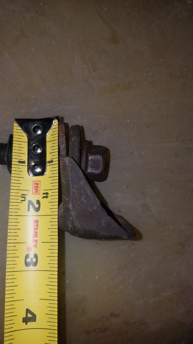

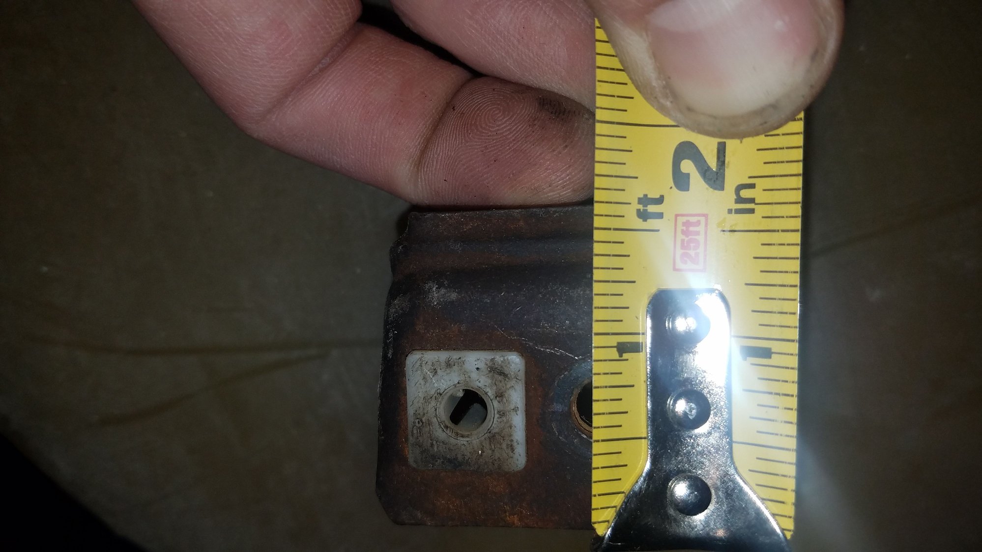

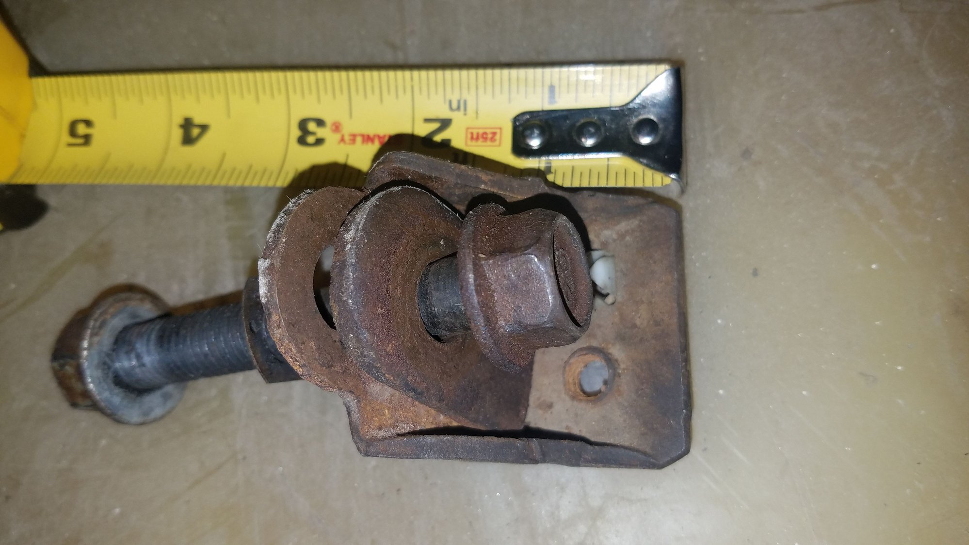

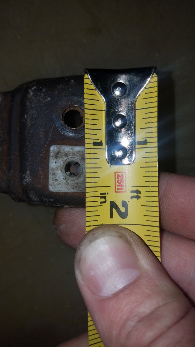

N. Jensen 05-01-2019 01:31 PM
Don, I'll post those bracket measurements on this thread tonight.

N. Jensen 05-02-2019 08:22 AM
https://cimg1.ibsrv.net/gimg/blazerf...c92aba8f45.jpg
https://cimg7.ibsrv.net/gimg/blazerf...1e58dc2e91.jpg
https://cimg0.ibsrv.net/gimg/blazerf...f2b38b6ecc.jpg
https://cimg4.ibsrv.net/gimg/blazerf...671024e27d.jpg
https://cimg8.ibsrv.net/gimg/blazerf...0e70a033da.jpg
Don, you're handy enough that you could make angle iron or strapping work.

Muchly appreciated! Will have to see what I can come up with. I'll post pics when I do fabricate something...
