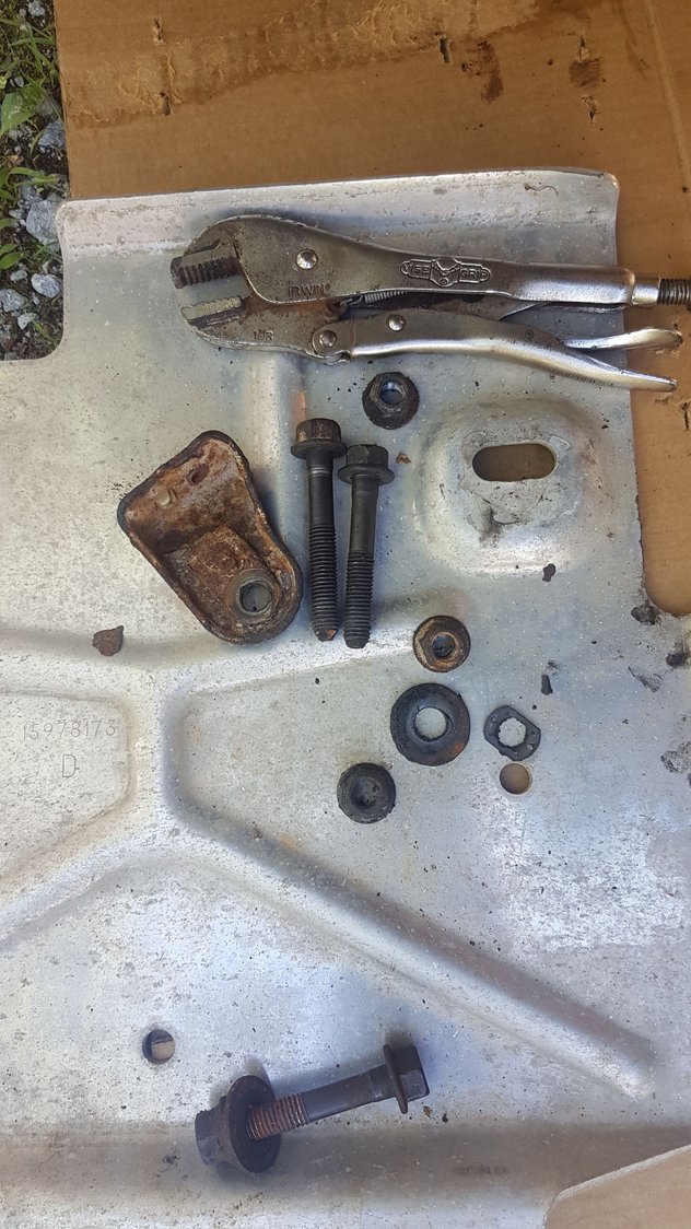

Okay, I can't be the only one who has faced this. I'm trying to get the bolt out on the passenger side to install the bracket at the oil pan skid plate and the bolt doesn't have enough clearance to come out! Any tips/advice? The vice grips were there to try to get a bit more clearance, perhaps I need a C-clamp or something bigger? I also tried cussing at it, but perhaps didn't try hard enough.
Also, I realize there is grease on the left side of the photo. It's from my CV shafts...soon to be remedied.

DonL 11-07-2020 02:25 PM
The engine needs to be jacked up a little. Put a piece of wood over the entire oil pan, 2x6 should work. Then jack it up.

rsaunders80 11-07-2020 07:27 PM
https://cimg4.ibsrv.net/gimg/blazerf...8fb4081d60.jpg
​​​​​I was able to get a bigger clamp in there and create enough room to remove the bolt and install the bracket. Not sure exactly how I would jack up the engine using a 2x6 unless I removed the engine mounts. Seems like an excessive amount of work just to add a bracket...if that were the only route I'd probably find myself running a skid plate with only 3 bolts.
DonL 11-08-2020 12:14 PM
Put the wood on the jack, to not damage the oil pan, then raise the jack. itll raise a little without removing engine mounts...
