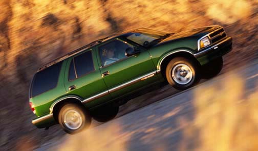

Question what color code is this?
anyone know the exact color code and name of this Blazer Color??
is this Fairway Green Metallic??
thinking about painting my blazer this color...

I believe this is either emerald green metallic or fairway green metallic...
43/WA177B - Emerald Green Metallic
87/WA309D - Fairway Green Metallic
But after looking at the chips in the links above, it looks like it is the 87/WA309D - Fairway Green Metallic. I found those by using http://www.expresspaint.com/ and plugging in a 1997 Chevrolet.
WA309D is the GM paint code which translates over to PPG 5250, Dupont D9729, & Sherwin Williams 53516.

It's not like the picture in the first post is color corrected and certified, either. Trying to guess what a color code is from a photo is a recipe for disaster.
