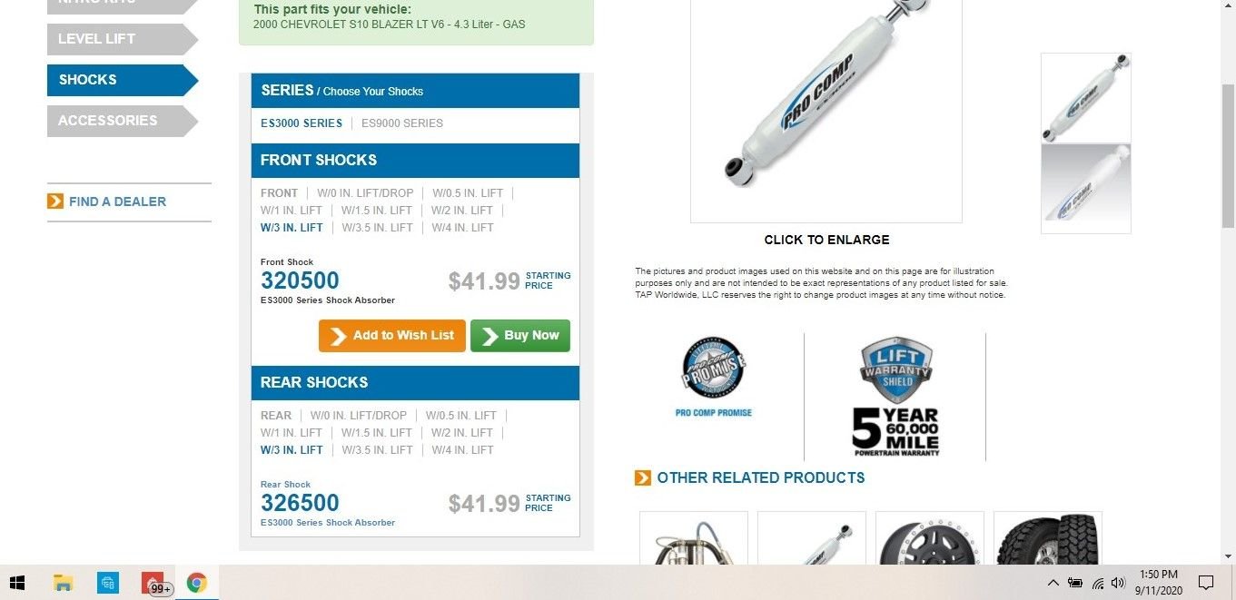

*EDIT*
Pro-Comp actually lists them by application (for my year, anyway, but yours should be the same). They show the stock length for a 2 inch lift, and this is what they show for a 3 inch lift.
