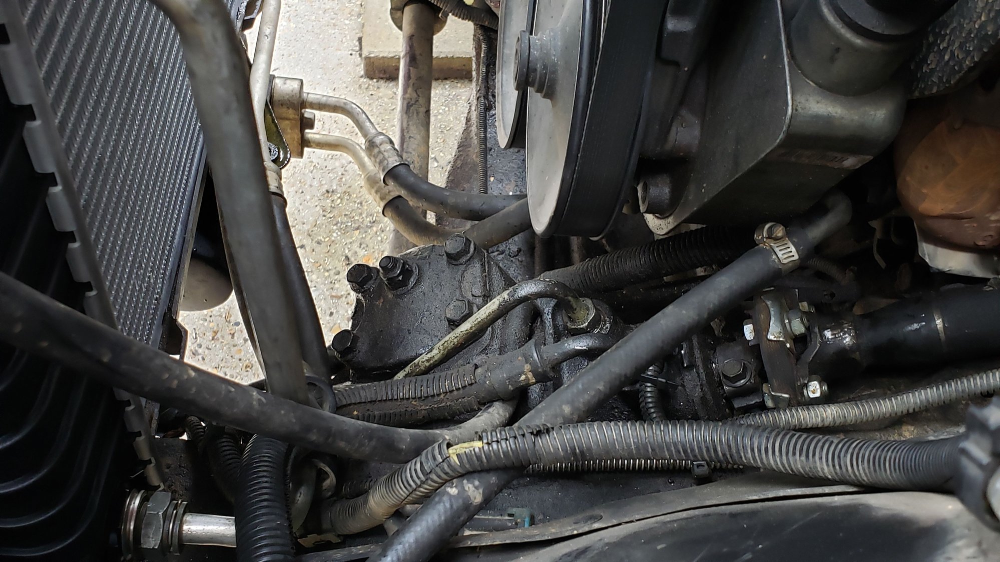

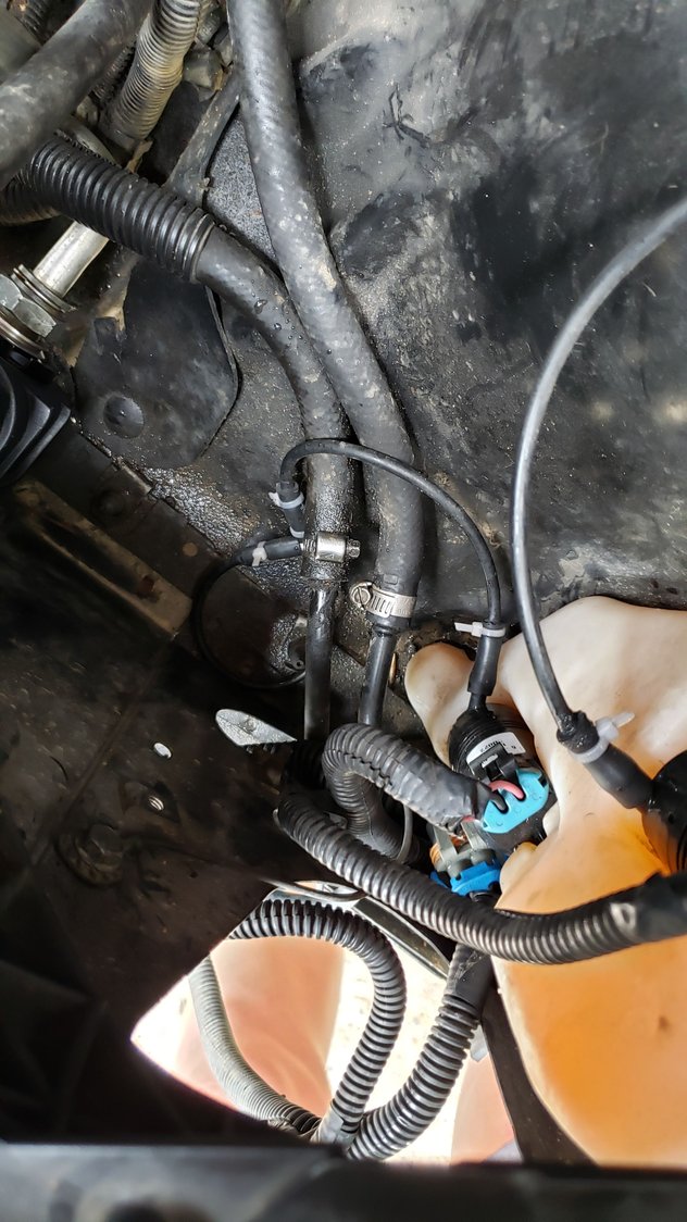

Americannoli 07-07-2020 10:23 AM
Originally Posted by Tom A (Post 724266)
Will do!
https://cimg3.ibsrv.net/gimg/blazerf...41ed0882f1.jpg
https://cimg8.ibsrv.net/gimg/blazerf...c5505b1651.jpg
https://cimg5.ibsrv.net/gimg/blazerf...93b55caa68.jpg
https://cimg0.ibsrv.net/gimg/blazerf...3779a6cbf2.jpg
Here's a couple of pictures. I don't know where the leak is coming from. I thought it was the line going into the box cause the fitting had a little on it but then I saw the lines going to the cooler and the return lines. First, what do you think the leak is and second, what would be the best way to get at the lines at the rear of the pump.
Tom A 07-07-2020 02:12 PM
Those lines are notorious for leaking at the crimps where the fittings are attached. Hard to tell on yours, though. Check the "cooler" (really just a couple of coils) to make sure it isn't rusted through, too.
The easiest way to get at that fitting would probably be to disconnect the steering shaft at the steering box and move it out of the way. Make sure you don't turn the steering wheel while it's disconnected.
Americannoli 07-07-2020 03:35 PM
