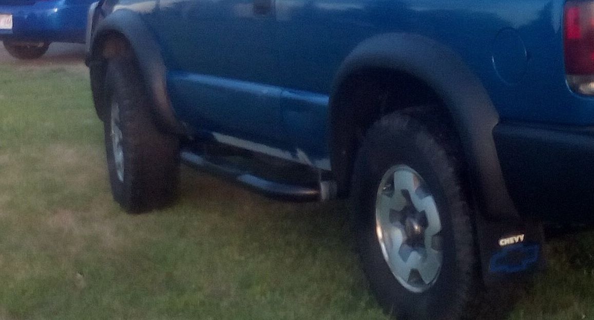

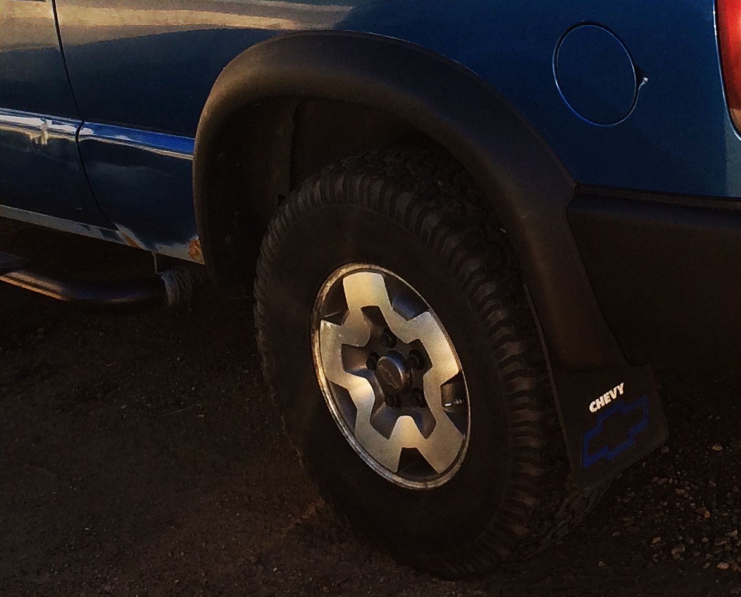

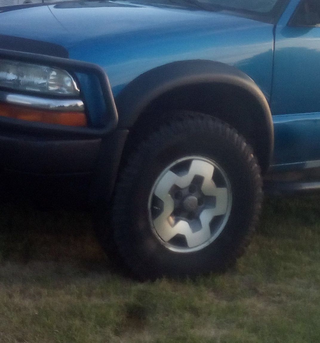

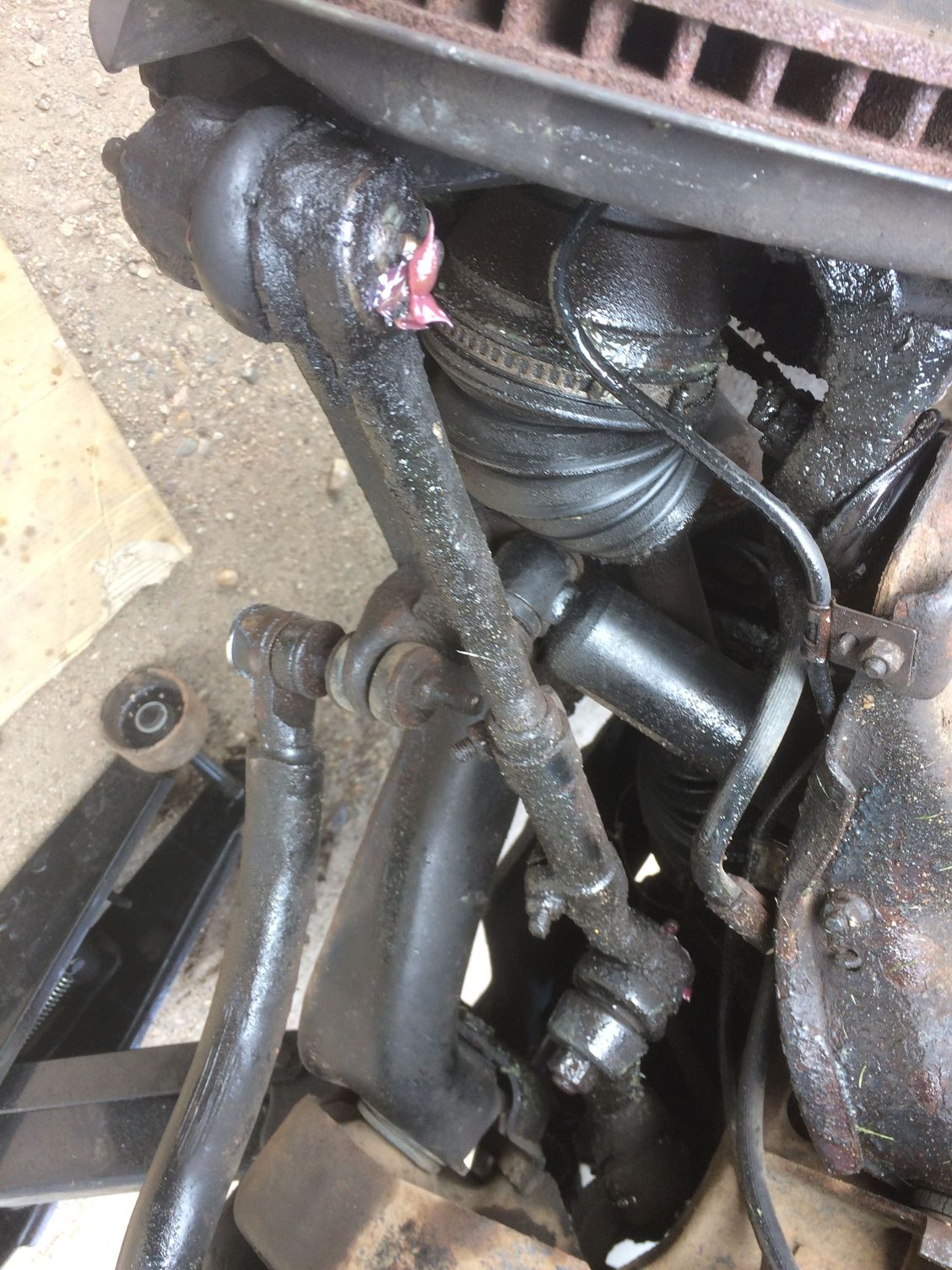

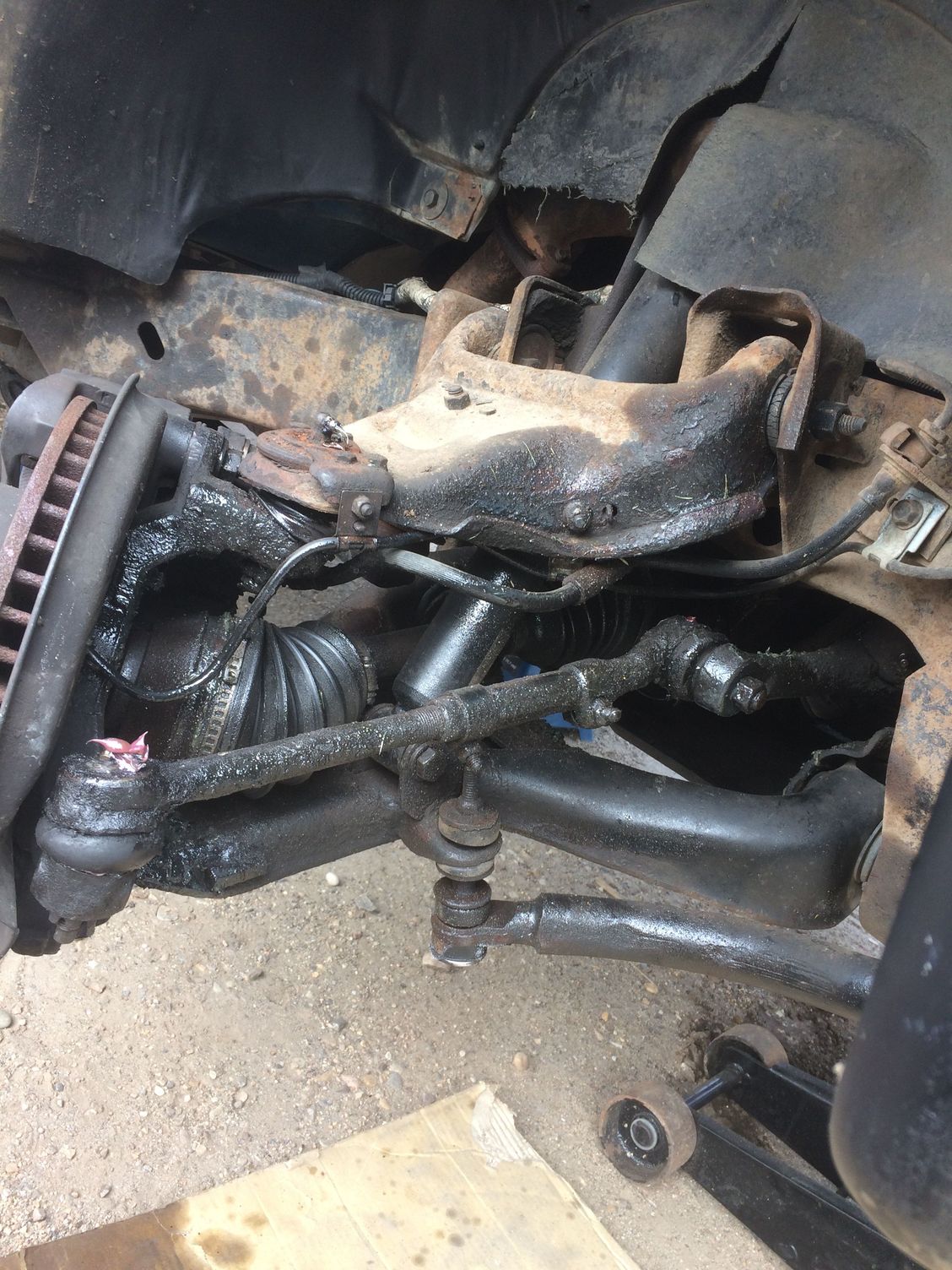

Vond88 08-04-2018 02:10 PM
Originally Posted by 2004 Blazer (Post 692830)
Measure the front track width to determine what model you have 61" ZR2, 57" LS. The previous owner may have swapped the rear axle or you may not have a ZR2. Post some pics of the A-Arms and frame mounts, also the rear spring forward mount is different on the ZR2.
On the inside of the glove box door is a sticker with a bunch of letters and numbers, grouped in 3s. Look for that option code (ZR2). If it's not on the sticker, you don't have that option.
https://cimg0.ibsrv.net/gimg/blazerf...bb20bfd05.jpeg
https://cimg1.ibsrv.net/gimg/blazerf...19d71cd37.jpeg
https://cimg6.ibsrv.net/gimg/blazerf...802cab7d9.jpeg

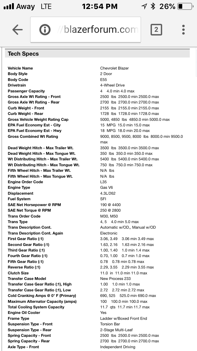

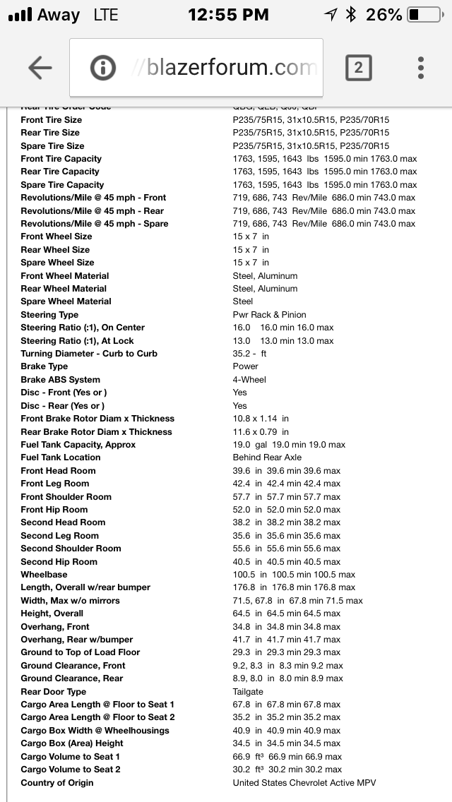

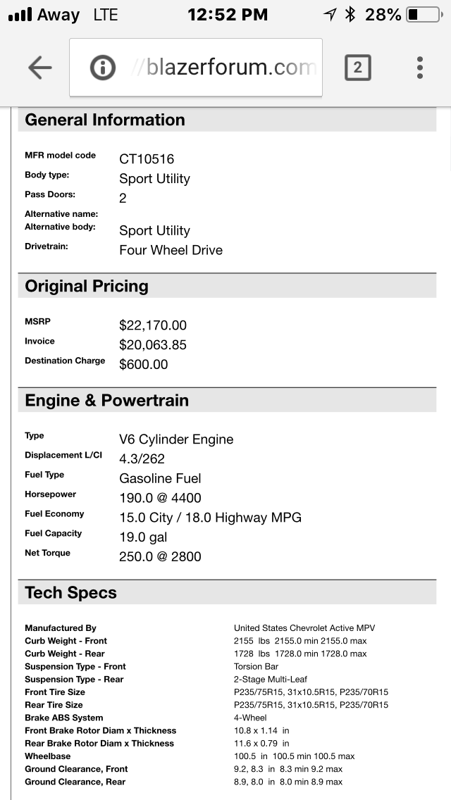

Vond88 08-04-2018 02:15 PM

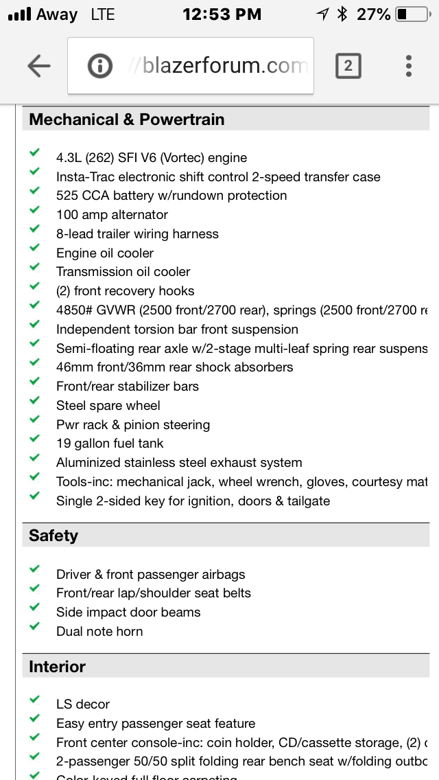

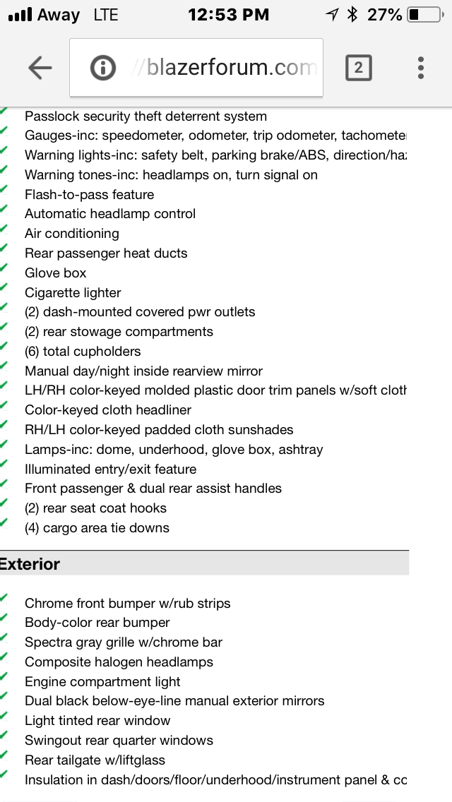

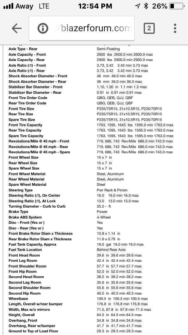

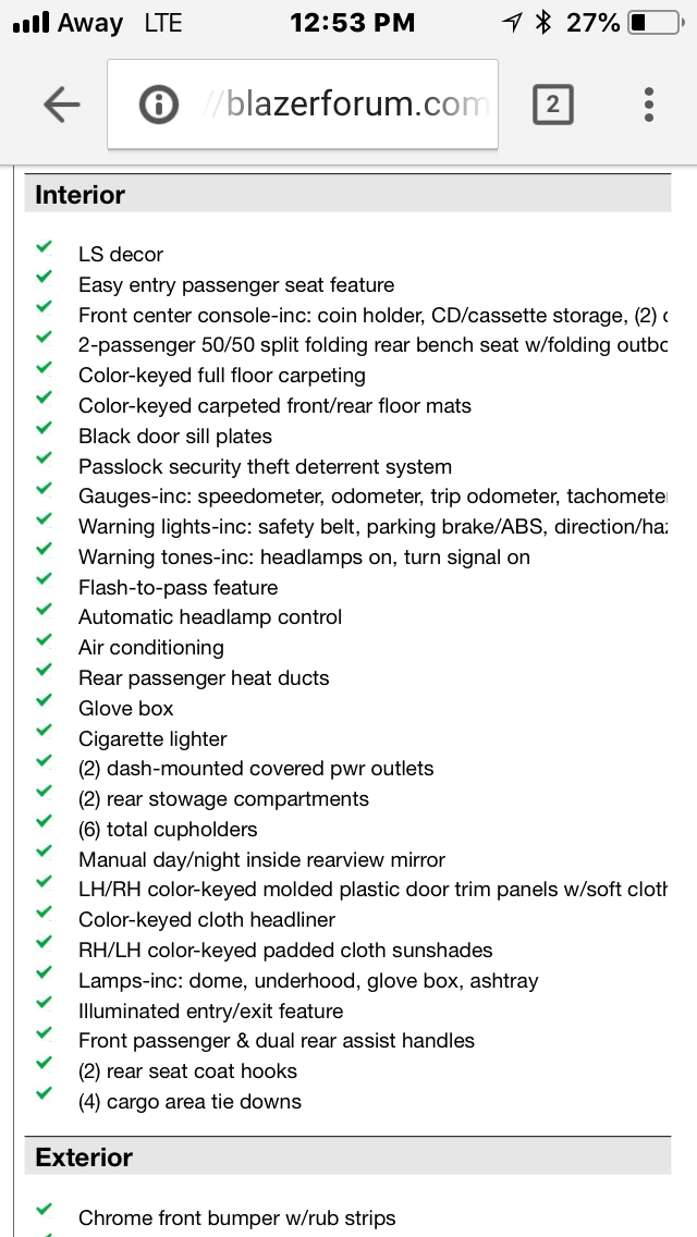

I couldn't find any stickers in the glove box. I used the vin decoder and this is what I got. https://cimg8.ibsrv.net/gimg/blazerf...ddcf59cd10.png
https://cimg9.ibsrv.net/gimg/blazerf...b30a3dd9c6.png
https://cimg0.ibsrv.net/gimg/blazerf...cfa46ac221.png
https://cimg1.ibsrv.net/gimg/blazerf...1c86e68b15.png
https://cimg2.ibsrv.net/gimg/blazerf...60cde6e50d.png
https://cimg3.ibsrv.net/gimg/blazerf...897ab4c1a5.png
https://cimg4.ibsrv.net/gimg/blazerf...4dc222e0fc.png
Vond88 08-04-2018 02:30 PM
https://cimg6.ibsrv.net/gimg/blazerf...d291efa29.jpeg
https://cimg7.ibsrv.net/gimg/blazerf...5e481007d.jpeg
https://cimg8.ibsrv.net/gimg/blazerf...235b829c8.jpeg
https://cimg0.ibsrv.net/gimg/blazerf...3773fecf1.jpeg
Height front and back. It has 31in BF Goodrich All Terrains on it.
