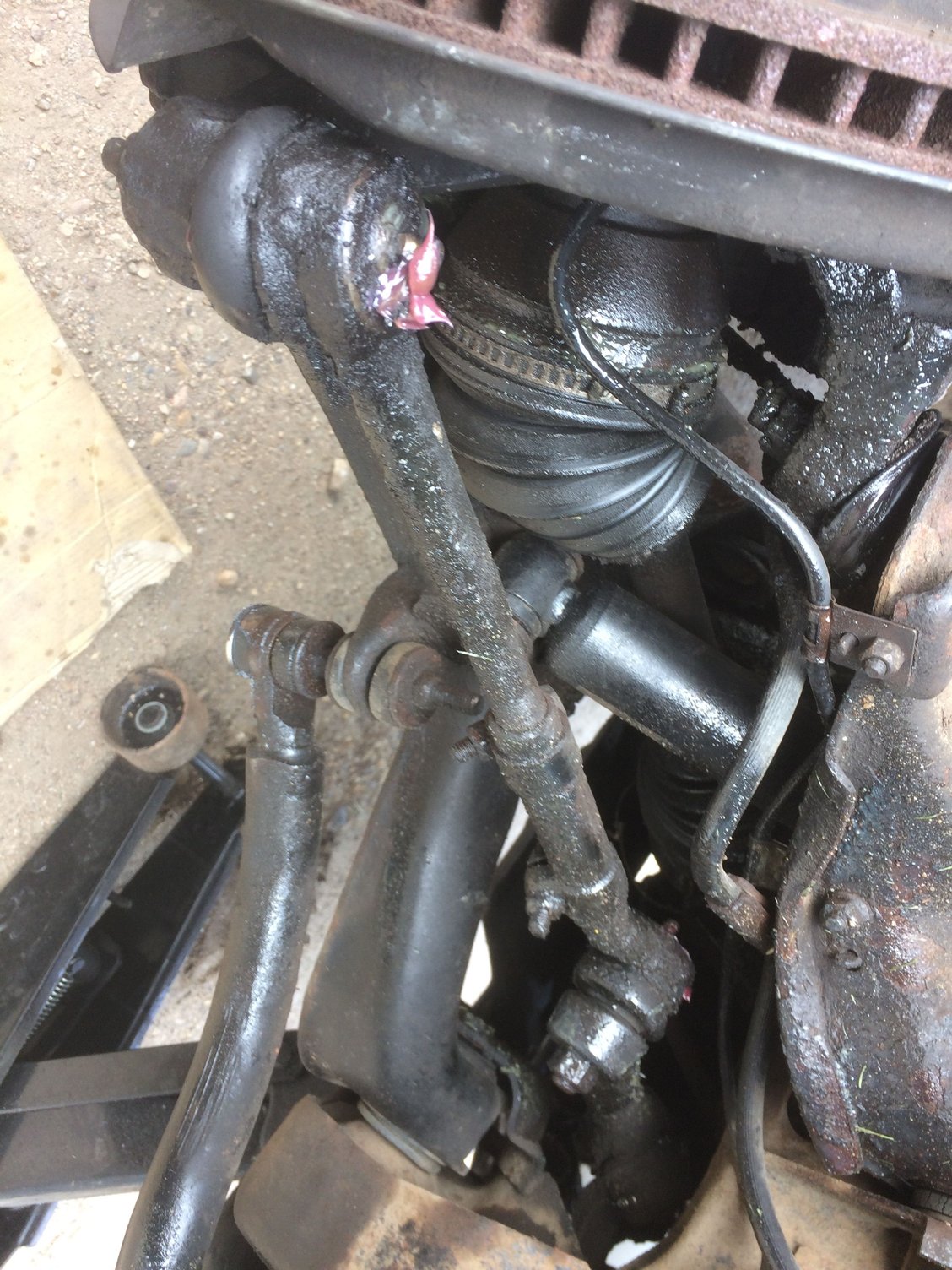

I got the parts and had been changing them as i had time. Got the hubs and ball joints done now with no problem. Was about to start on the steering but noticed my parts do not look the same as what is on there now. The outer tie rods on my truck are longer tthan what I have in my kit. I ran into rhe same problem with my cv axle so I figured they were different. Can’t find anything online about it. Im sure its somewhere tho.
