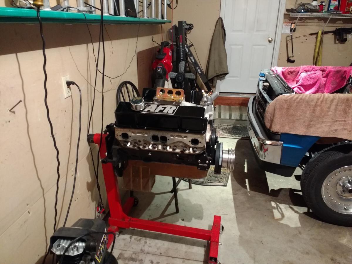

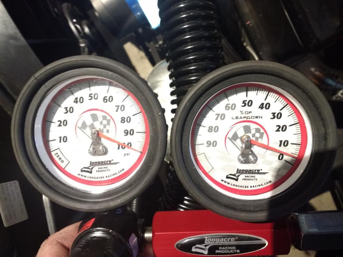

Took cranking compression and leakdown rates on warm engine before pulling out for teardown. Seems to still be OK after 4 seasons of racing. No evidence of detonation on the pistons. Ended up buying a Lunati 401B1 camshaft which is nearly the same as a Crower 00307 (106° LCA) but designed specifically for 383 and 406 Chevy engines with 10.5:1 compression running in the RPM range where I am at (100° intake centerline - 6° advance ground into the camshaft!). Should be an entirely different animal than my little XE274H street hydraulic cam (110° LCA, 106° intake centerline)! Engine is disassembled down to the short block and I'm ready to try out the new cam for rod clearance tonight!
Interesting thing is that the lift/duration on the XE274H with my 1.6 rockers is similar to the lift/duration on the 401B1 with 1.5 rockers (what I will be running). It's the valve timing that is WAY different! The lower LCA valve timing should make the torque peak much bigger, but in a narrower range. The intake centerline of 100° (full 6° advance) should help bring that peak down a bit in RPM (for the lower RPM limits of the stroker motor). Apparently this is why the 401B1 cam is specified for the 383/406 with the 3.75" stroke. Should idle extremely poorly, but really come on like gangbusters when it hits the RPM where it can take advantage of the greatly increased intake/exhaust valve opening overlap! The exiting exhaust starts to pull in the intake charge even before the exhaust valve closes - why race engines can have greater than 100% volumetric efficiency. I don't care about the idle, because my converter stalls at 4100RPM and I'm not trying to drive it on the street anymore.
One other thing I will need to check when going back together is the piston to valve clearance. It won't really be opening the valves much more than before, but it will be opening them at different times.
Here's the compression and leakdown
#1: 200# 4.5% #2: 200# 4.0%
#3: 200# 3.5% #4: 205# 4.0%
#5: 210# 4.0% #6: 200# 4.0%
#7: 210# 6.0% #8: 200# 5.0%
