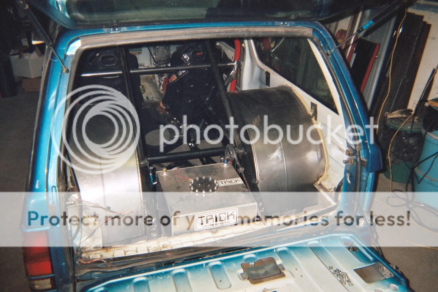

spib 07-13-2006 12:09 PM
spib's drag blazer
http://i63.photobucket.com/albums/h1...th_022_19A.jpg http://i63.photobucket.com/albums/h1...th_021_18A.jpg http://i63.photobucket.com/albums/h1...th_020_17A.jpg
http://i63.photobucket.com/albums/h1...th_018_15A.jpg http://i63.photobucket.com/albums/h1...th_016_13A.jpg http://i63.photobucket.com/albums/h1...th_015_12A.jpg
http://i63.photobucket.com/albums/h1...th_014_11A.jpg http://i63.photobucket.com/albums/h1...th_013_10A.jpg http://i63.photobucket.com/albums/h1.../th_004_1A.jpg
my 1983 s10 drag truck meloy toy!!!!!! be done fall of2006 race spring2007

spib 07-13-2006 02:47 PM
RE: spib's drag blazer
the motor that will be going in at first is a motor on stand that went 13's in a 76 1/2 ton truck, its a 355 400hp, will use a turbo 350 3600 convertor foot brake off the line loc, should go easy low 12's play around and should go high 11's. Future plans in a few years are 509 or 555 with a glide and a 5500 convertor off a trans brake, replace mopar rear with 40 spline 9" and launch at 5000, I want to go low 10's thats my goal. this year I have back halfed this blazer, got 24 ft tag used and a dually 87 4 door. So I am way ahaid of my origanil plans, I also have a 67 shortbed c10 that my wife and I take to car shows and have big plans for that. It just cost a lot to play with these toys!!!!!!!!!:) this blazer is doing two things, it is my race car, and its a street legal tubbed out truck. :):)

spib 07-21-2006 02:09 AM
new pics of tin work, drive train next!!!!!!!!!!!!!!!!!!!!!!!!!!!!!!
[IMG]local://upfiles/3183/36F6538EAEC940879D945E050AE1D358.jpg[/IMG]
[IMG]local://upfiles/3183/FD75327FC45D4AD59BFF5BF739BF7887.jpg[/IMG]
[IMG]local://upfiles/3183/926BEACD6254460DA954999951E83833.jpg[/IMG]
[IMG]local://upfiles/3183/A5B6A5A79F564D98AF1779E2FE7129FA.jpg[/IMG]
[IMG]local://upfiles/3183/30C259259B2F493B8D88EB02EC477F77.jpg[/IMG]
