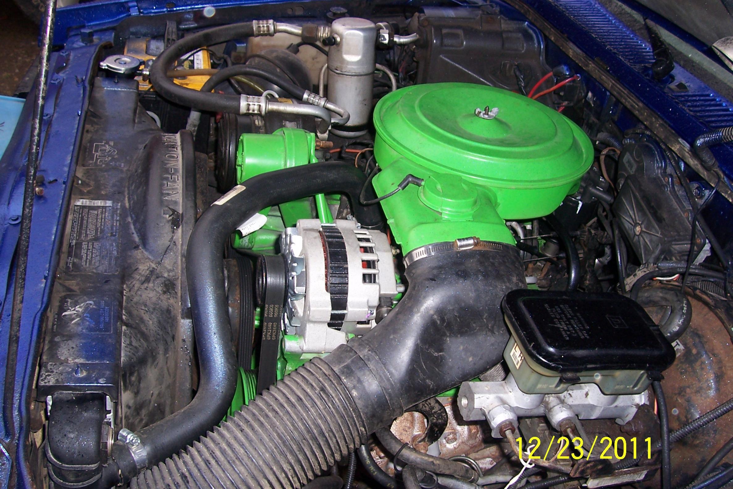

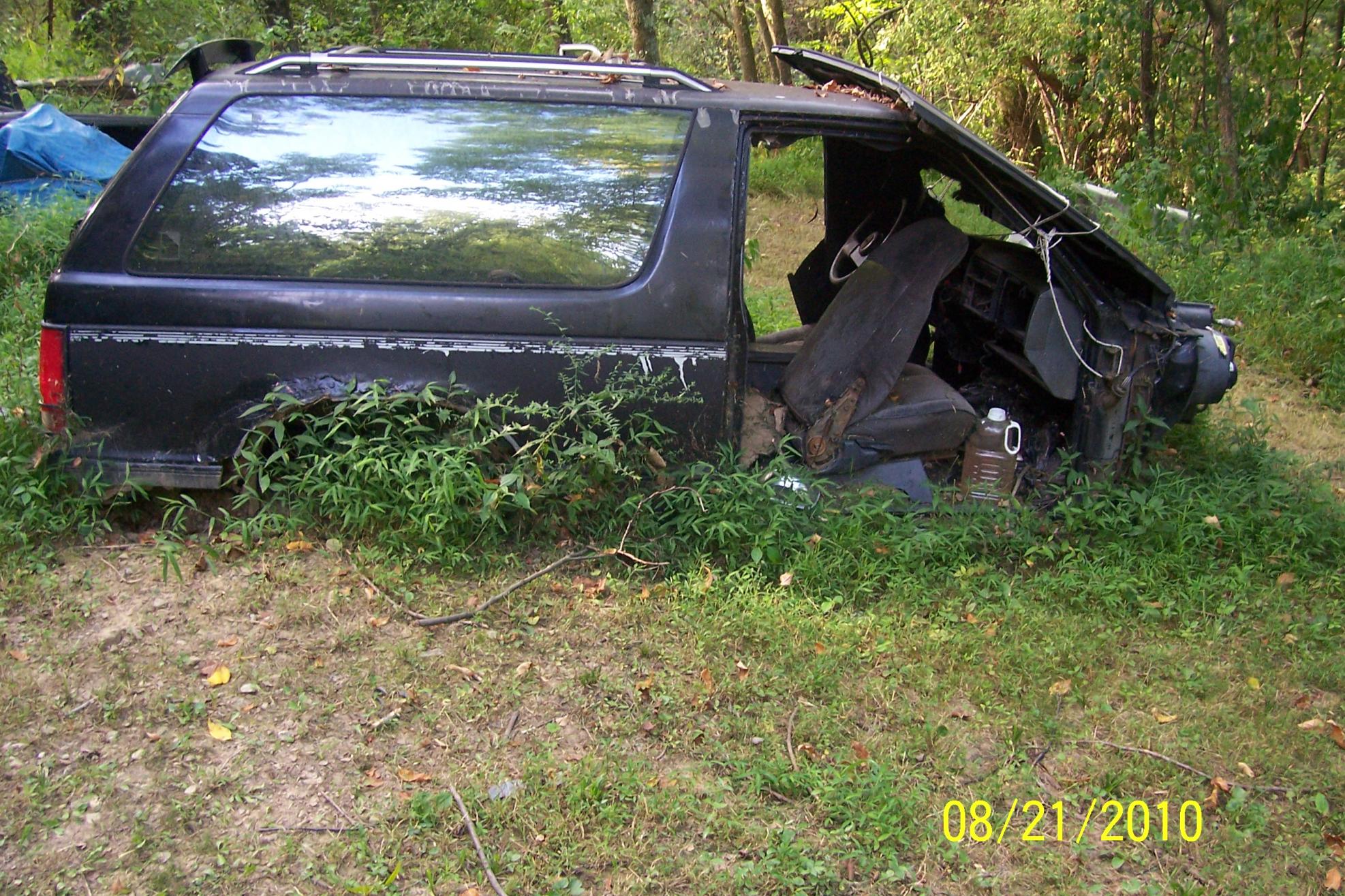

The blue blazer is the one we have been working on.
More or less started left to right.
Now the engine has the original vortec cpfi on it.
