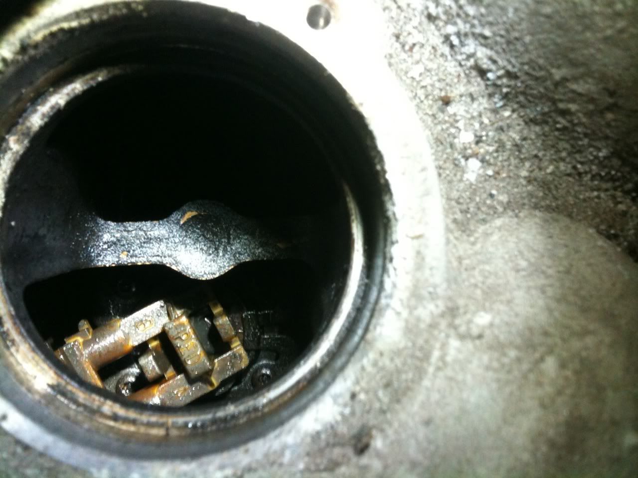

Take off the VORTEC cover plate, and remove that black puck looking thing and look in there with a flashlight. Is it black everywhere?, or gold in some spots?

I also checked the oil smelling like gas or oil. I actually forgot to take a good whiff, but I do not recall smelling gas. It did, however, have what I assume to be the gold spots. Picture below.

Today I smelled for gas when I opened up the plenum and definitely smelled it. It appears there was indeed some sort of leak, I could see that a large section of the passenger side of the compartment was indeed "clean". So I replaced the FPR and the gasket that goes around that section and it appears to have made no difference. My vehicle still will not start on its own and the fuel pressure is not getting high enough.
Here is a picture of what it looked like inside:
http://img.photobucket.com/albums/v39/Gerik/head.jpg
