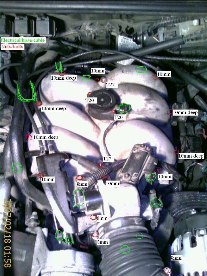

http://i11.photobucket.com/albums/a1...colorcoded.jpg
the black round thing on top of the engine is what i am talking about. and it is not broken it actually is able to come apart, and since i was not able to open up the engine i was not able to smell anything at all

The thing is the IMTV, or Intake Manifold Tuning Valve. Depending on the needs of the engine, it turns it into a single plenum or a split plenum.
