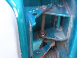

Default RE: door hinges
http://img.photobucket.com/albums/v6...6/IMG_3374.jpg
Do they look like that?
If you notice, that bushing is broken. Well a long time ago the spring in the door fell out, never got it back in. Took it to my auto mechanic, not even he could get that damn thing back in. It's been sitting in my cup holder ever since.
Anyway, over the summer I was in my friend's driveway picking him up. I opened my door and heard a *ping* sound. Turned around and my door was hanging off. As you may know, the top pin is held in upside down by the bushing. My bushing cracked in half, the pin slid right out of the door and the door was hanging on by the bottom pin. So my friend comes out of his house and sees me leaning up against the side of my truck with my arm through the window holding the door on as I tried to slide this rusty pin back into the hinge.
I eventually got it halfway in after hammering it to death, and one day it just slid in perfectly like that. I don't know when it happened, but it's been in there ever since. That thing's too rusty to move. A little multi-purpose oil when it squeaks, but good as new.
