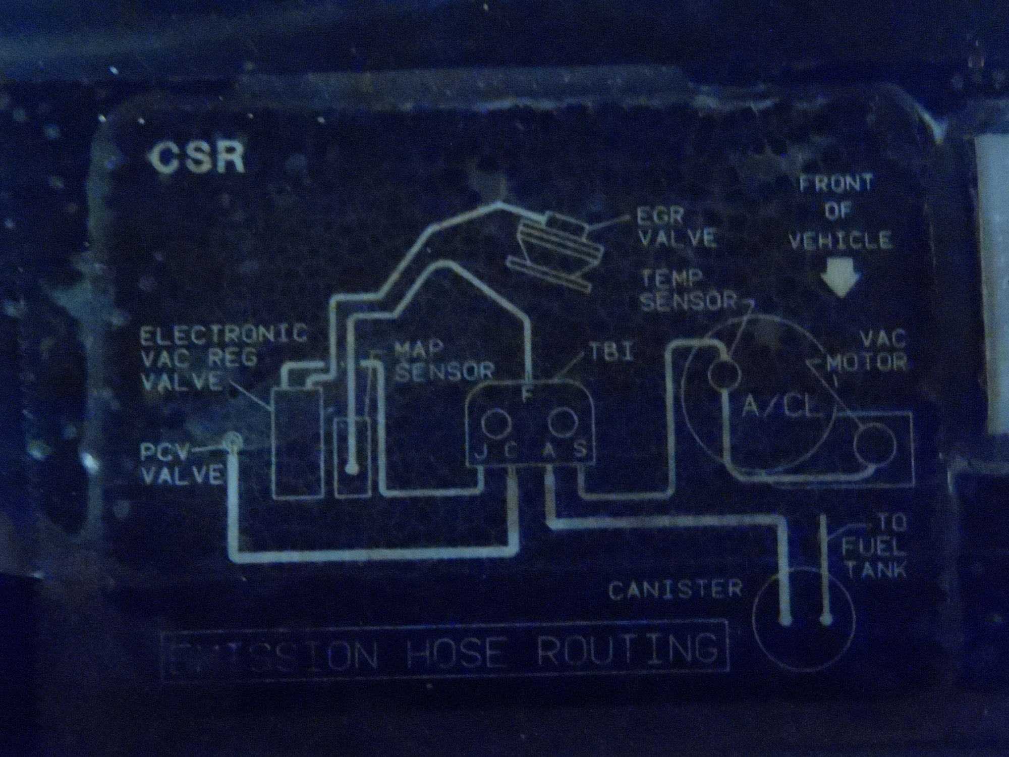

hi i need help with the vacuum hose diagram for my s10 blazer 1989, vin Z, 4.3L, the tbi have in the front 4 letters (J-C-A-S), i am building this engine and i need to finish the part of the tbi.

Attached is a pic from my OEM decal.
