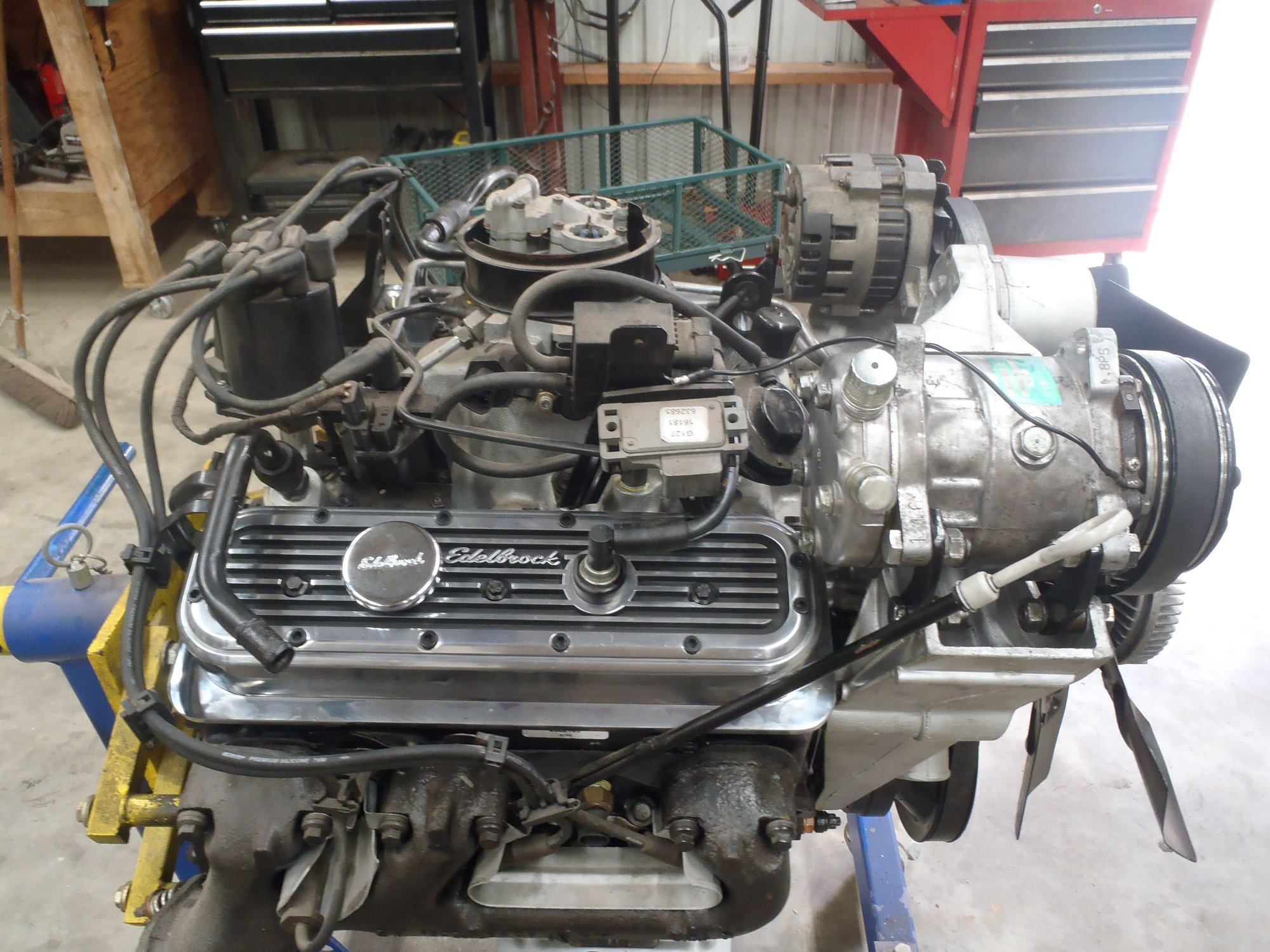

I finally was able to start the engine on my S15 Jimmy 2WD after 2 years. The engine was pulled due to an Oil Pan leak and morphed into painting the front clip and modifying the Engine.

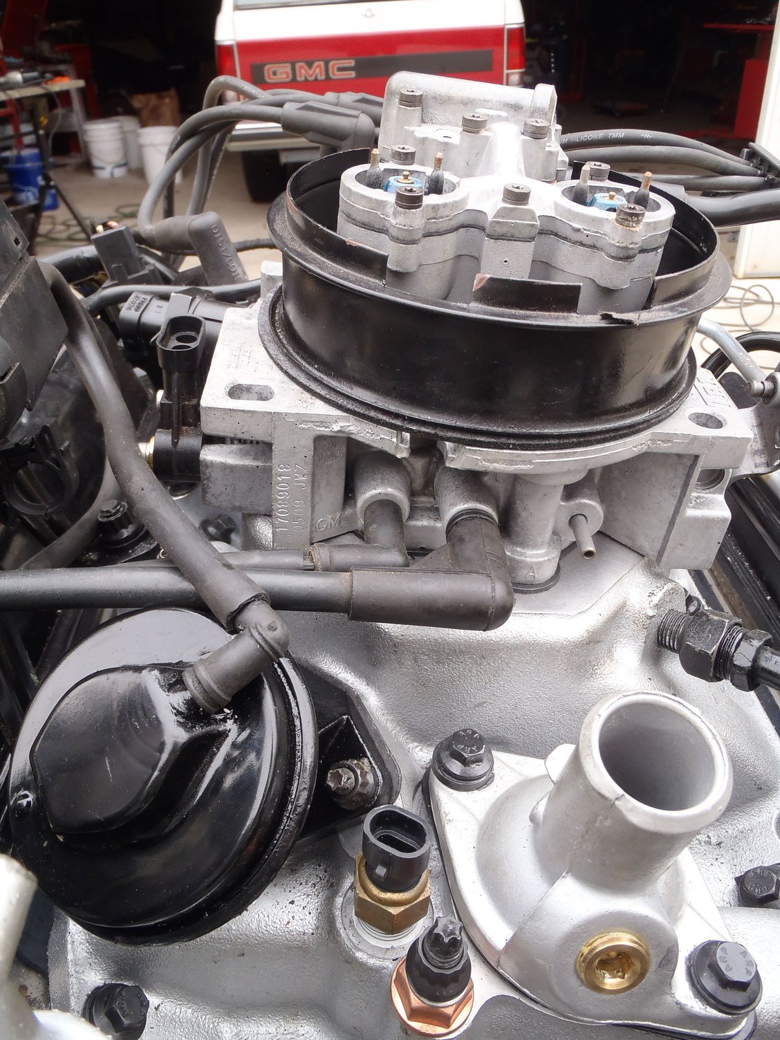

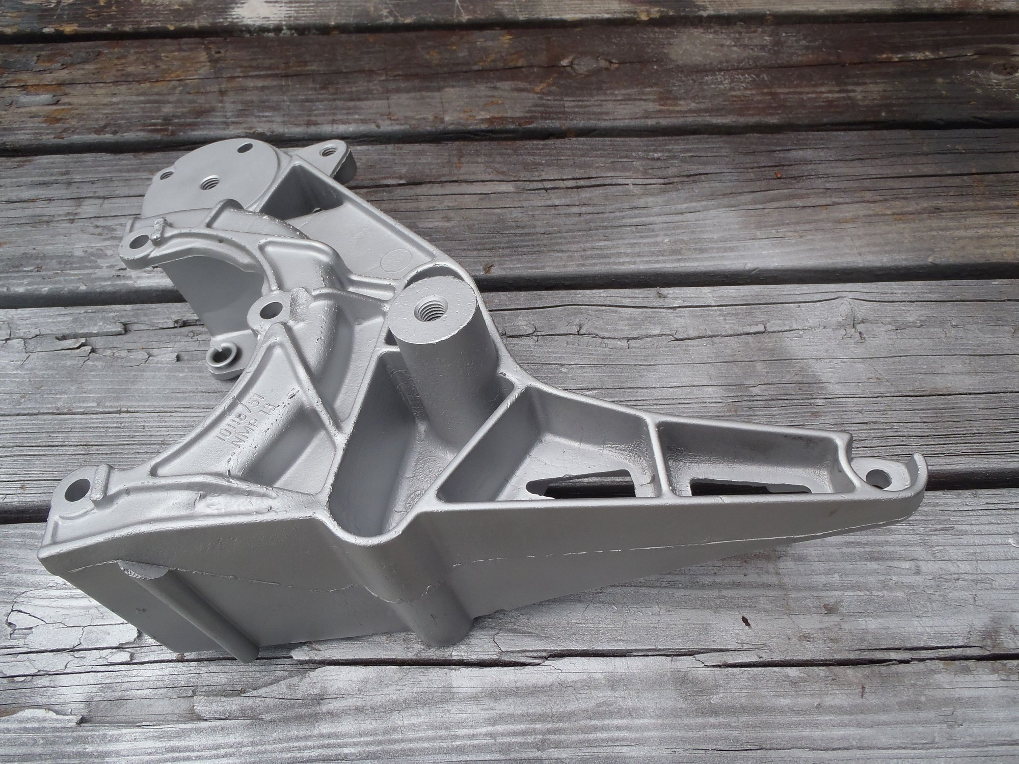

Engine Mods: Rebuilt 94 Eyebrow Heads, Edelbrock Intake Manifold, Edelbrock Cam Shaft, Edelbrock Roller Timing Gear Set, Roller Rockers with 1.51 ratio, Edelbrock Water Pump. Edelbrock NOS Valve Covers. Edelbrock OBD1 Chip. AC accessory bracket without air pump provision installed. (Pulled bracket of a V8 Pickup). Pulled AC support brackets from V8 that mounts to the face of the block. Relocated Engine Ground to lower right side of block. Relocated ground on water outlet stud to the bolt hole that was used for the AC support bracket. Water outlet housing can be removed with just 2-Bolts., The Intake manifold no longer has any studs for grounds or support rods. ARP bolts were used for Intake Manifold Bolts. Sanden air compressor with custom mounting brackets. New Tough Stuff Power Steering Pump. New MSD Coil, New Distributer.
Relocated ground from water pump studs.
Custom bent, swaged and silver brazed fuel lines from linkage to TBI. to allow for adding fuel gage adapter.
Accessory bracket from V8 that does not have the Air Pump provision. Freed up lower bolt hole to use as the engine ground.
