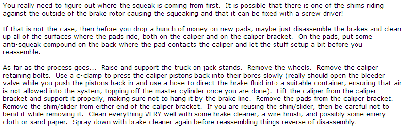

Old Jun 24, 2008 | 11:13 AM
Posts: 41,341
Default RE: 01 BlazerLT Squeaky Brakes
