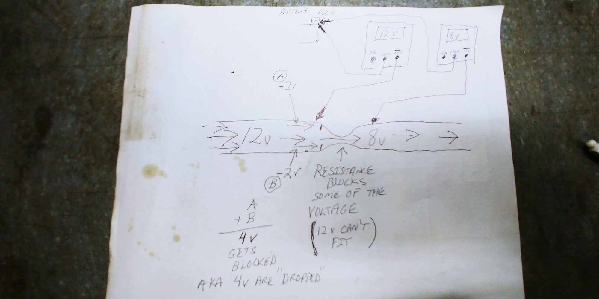

I get the picture about voltage testing, looking for a voltage drop somewhere in the system. The problem I see there is if battery voltage is present at the various fuses and any other tested points while all the gauges are working then I haven't found a problem, but merely proven the absence of one. The incident I mentioned in my first post was (so far) a onetime occurrence. Granted, it did actually happen twice, but both times within a couple minutes of each other and hasn't happened since. The engine was running both times.
I do see the logic in that issue being caused by either an intermittent voltage drop or a ground connection. I follow you on that. Where I get lost is in suspecting the key switch for supplying battery voltage to some circuits and reduced voltage to others. I may well be wrong in this, but I would expect that the switch would have multiple circuits, yes, but there will be only one start circuit, one acc. circuit, one ignition circuit, etc. I wouldn't expect it to supply multiple ignition related circuits from the "run" position and do some from more than one place in the switch. I don't know that for a fact, but that's been my experience with ignition switches I've dealt with elsewhere. I can see where the "run" position supplies multiple circuits, yes, and those could have a bad connection or two here or there making for a voltage drop.

If I understand your one question correctly, there are several circuits on the ignition switch. One or more of those circuits could have some form of resistance (corroded wire, etc) while other circuits are perfectly fine. I drew a very rough idea of how a corroded wire could prevent full source voltage from getting to a component.
P.S. My 'definitions' aren't literal, just a way to picture it. Also, this is only effective with the circuit loaded.
