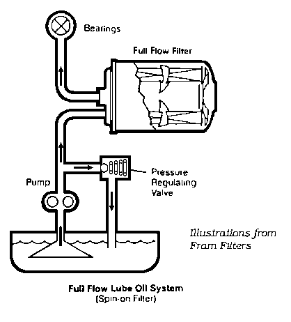

Could be the oil pump bypass valve is stuck open. A broken spring would prevent the oil pump from building sufficient pressure. Cheap, easy fix without having to remove the oil pan. The diagram below shows how the bypass valve works. The valve on the 4.3L is pressed into the block. The oil filter adapter must be removed to access it. If I remember right, the valve is under $10. Might be worth a try
How do I go about changing it? Never messed with this stuff.
