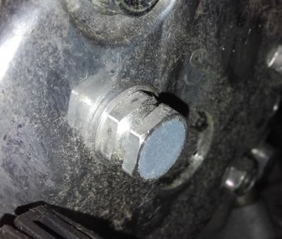

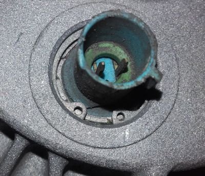

While doing my LIM gaskets I found my compressor busted too. Exactly as You have mentioned - at the seal. As I haven't seen a sense of getting a new one of bad design, I went for UAC replacement. I have received a parcel yesterday. Seems UAC is equipped only with a clutch plug, but does not have a pressure switch at the back. I think I'll shunt the contact, but I'm posting an info here, maybe somebody will find it useful...

The genuine HT6 sensor has a C-clip mount of a sensor, I bet it's unthreaded:
UAC has something that might be a threaded plug:
Thanks for the tip Chistine, I'll google for info on the pressure switch installation. Anyway, I don't feel I should care much about, as I have seen many ac designs that would clutch in and run the compressor even when empty...
