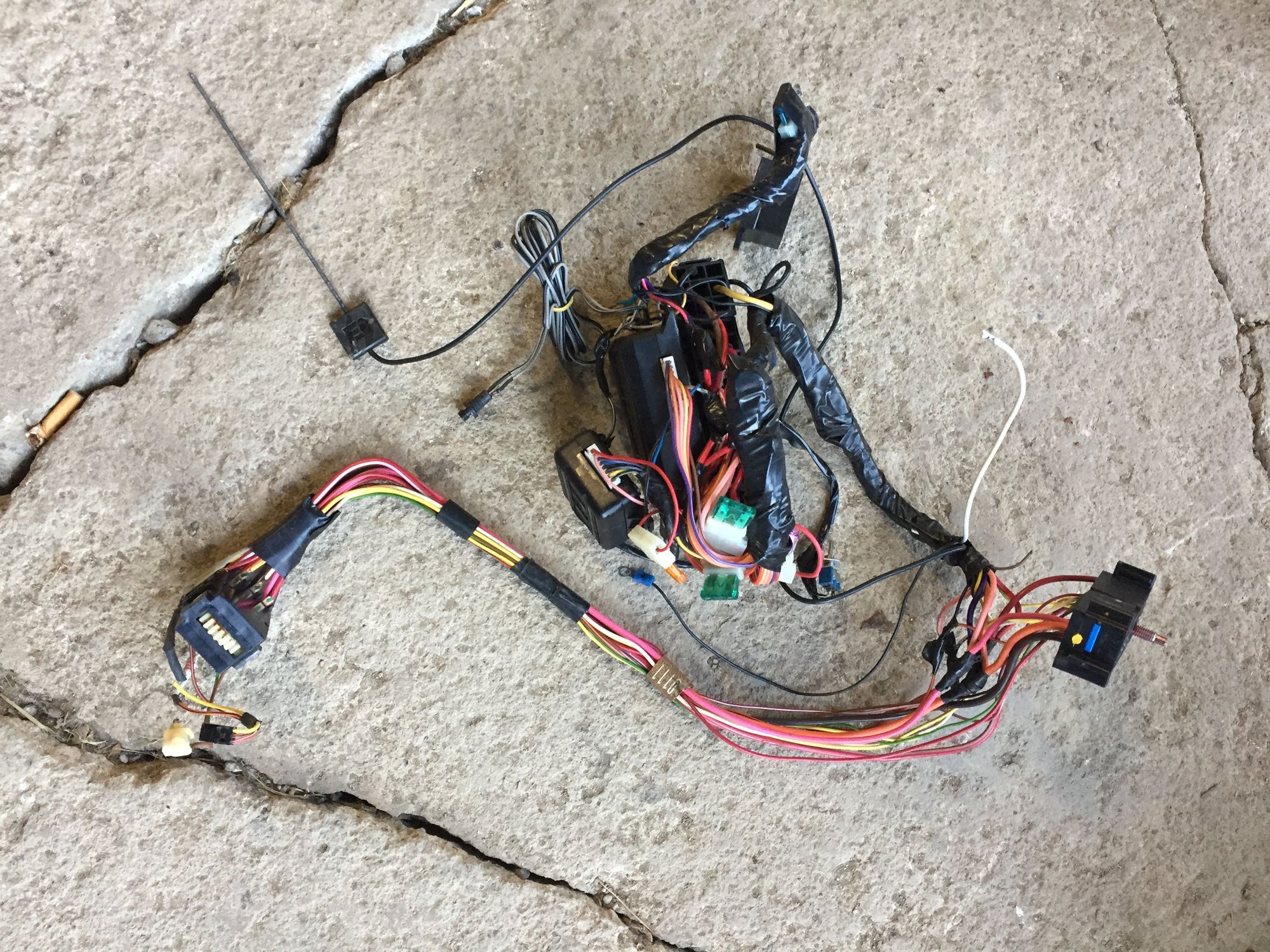

So I found this remote mess wrapped up like softball under the lower driver cover. I cut it out and got an ignition switch from the boneyard. So I end up at this point with the lights in pic never going off even with the key out and off. No start of course. Security light never goes out and doesn't blink, The driver side door lock actuator isn't working but passenger side is., dome and running lights still don't work, (replaced the switch already), the push button top map lights don't work, and the rear hatch button doesn't activate the latch actuator. This things didn't work before I pulled out the remote set up. I sure hate this vehicle right now! Any other ideas? BTW: If I would change the bcm, I've read that it will need flashed but if I use the Ecm that matches it from same vehicle would it work without flashing anything? That is finding a vehicle that matches as close to what I have now.
