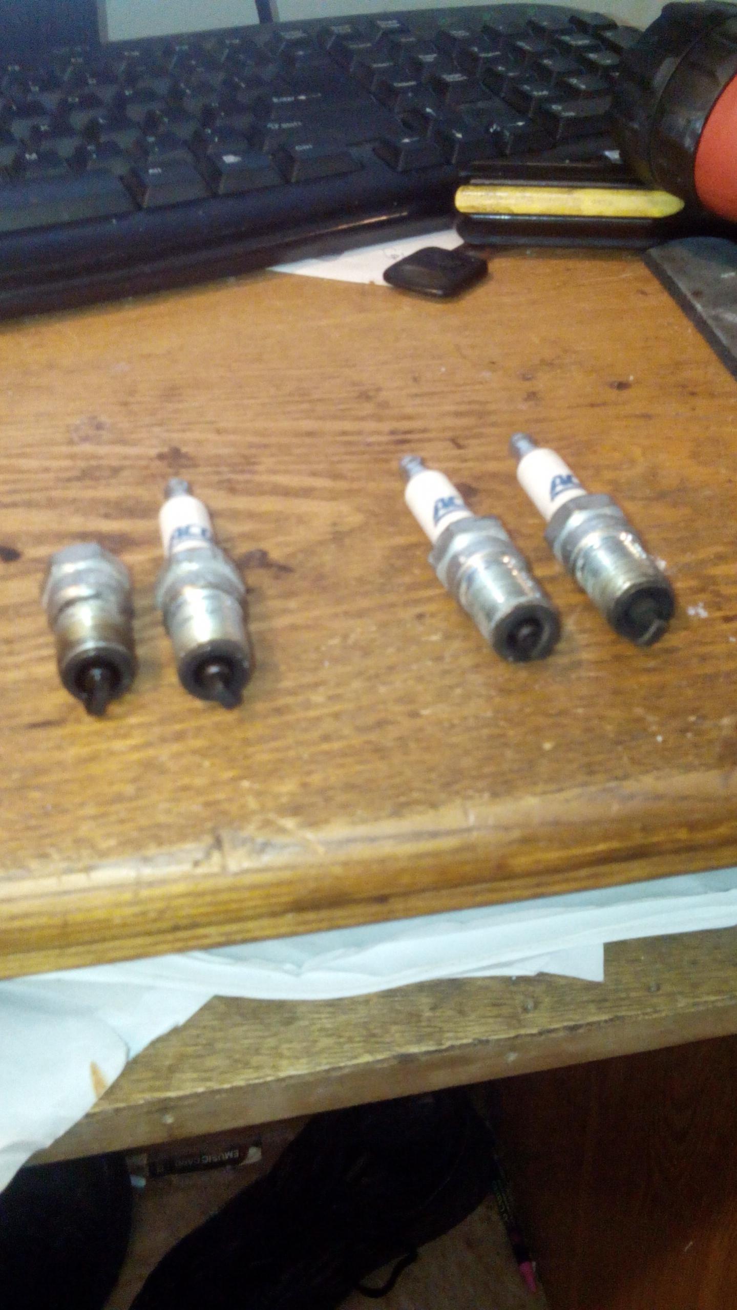

The two plugs on the left had extensive fuel on them. The others were dry.
With new distributor in and #1 piston top TDC the rotor points tp #1 position, where it says 6 on the outer rim of the distributor. Starting to think blown motor. Unless the injectors are plugged?
