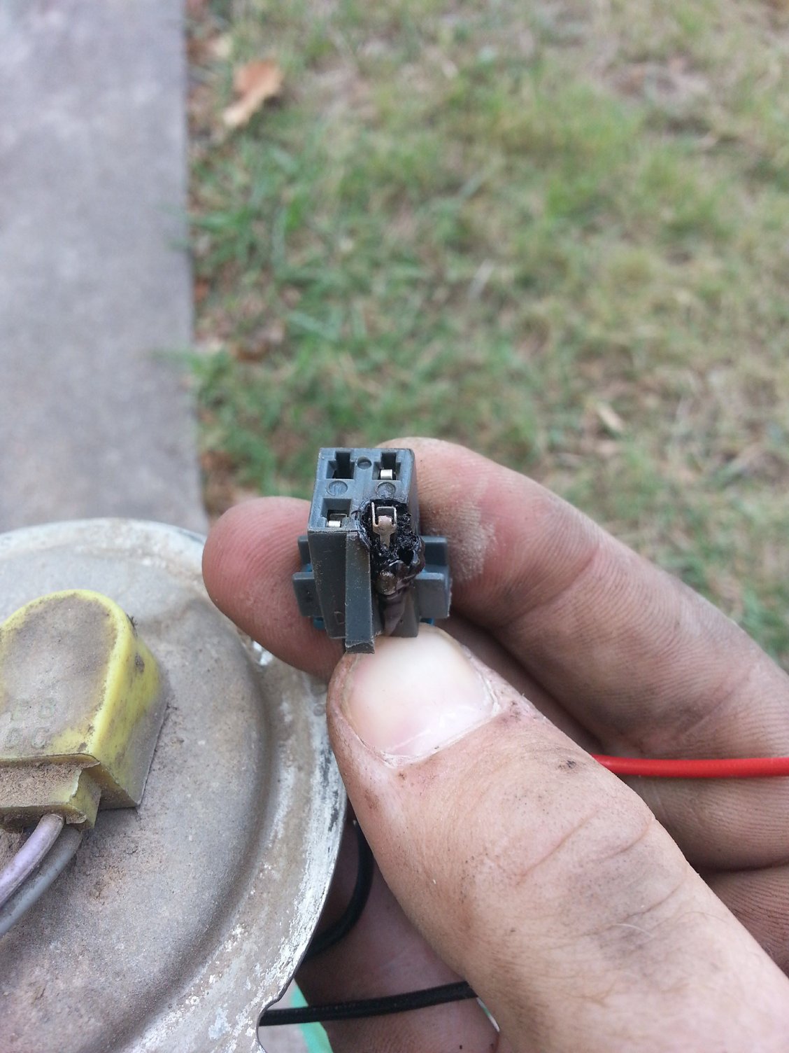

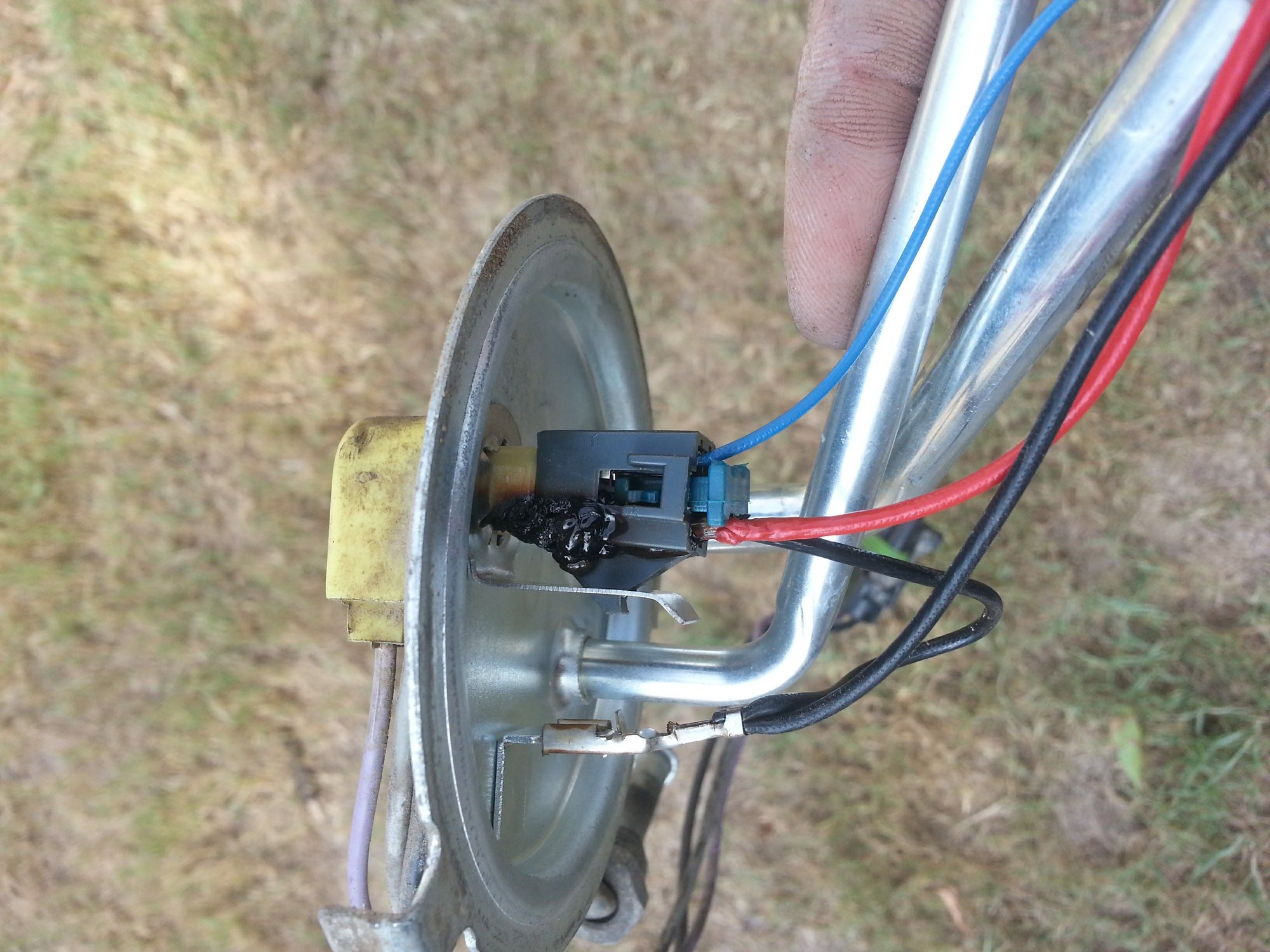

Had a similar issue. Truck would randomly die after being driven a bit. After a few minutes, it would restart, but do it again a few miles down the road.
I investigated, and ended up dropping the tank. This is what I found:
The harness for the pump was melting. When it got hot, and the resistance went up, I'm guessing it would lose connection, and stop the pump, stalling the truck. Once it cooled off, it would run again for awhile
Edit: I was cheap and lazy at the time lol. Instead of replacing the sending unit, I scrounged up some female wire lugs, crimped them onto the harness wires, and rolled like that for probably four years without a problem. I just replaced the sending unit last year
