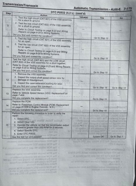

With P0502, the PCM does in fact command second gear only:
George

Thank you George. This information will be really helpful. I won't be able to follow up with you for a day or two due to work schedule.
One thing I did notice though is the VSS resistance spec in step 7 is no where close to the new one that i installed. As a matter of habit I regularly check replacement parts against what I remove. My original VSS was open( infinity) and the new replacement was 5ohms exactly. Mmmmm?

I don’t know the significance if any of the difference between the spec and your VSS resistance measurement.
Let us know if you need any help when you get back on this. Given the new VSS, the wiring is probably up next.

Well, I was able to run thru the diagnostics last night. The wiring from vss to pcm looked good with no opens, shorts to power or ground.
Resistance from pins 20-21 with vss connected was very low (5.5ohms).
A/c voltage across same pins while spinning driveshaft was .01-.003.
I removed the replacement vss and rechecked its resistance between the two terminals - 5ohms. I then checked continuity between each terminal and the metal threaded case- there was continuity.
So off to the local NAPA this morning and ordered a vss. Picked it up after lunch and installed it. Scanner showed mph reading which coincided with the speedometer and a road test found all is well in Blazer Land!
As a note the first vss was purchased on-line from a reputable auto parts supplier- I guess defective parts are more common now and as a lesson I will be more thorough with pre installation inspection and testing.
Thank you very much for all the help. The wiring and diagnostic charts really helped to pin point my problem.
