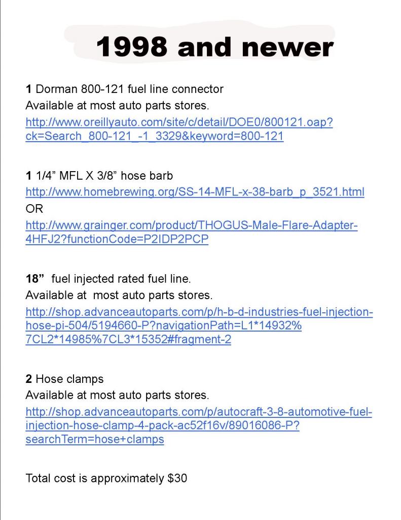

55-60psi at the service port is definitely a problem. With those readings, the problem could be in the plenum or in the tank. Checking fuel pressure & leakdown at the fuel filter outlet will tell you where the problem is. Just because the pump is new, doesn't mean it's good. You'll need an adapter that goes from the fuel filter outlet directly to the fuel pressure tester. All pressure & flow must end at the tester, with no fuel allowed to the engine. While the pump is running, pressure must be 73-108psi, and it must remain above 55psi for at least 10 minutes after the pump shuts off. Here is a parts list for building the adapter:
